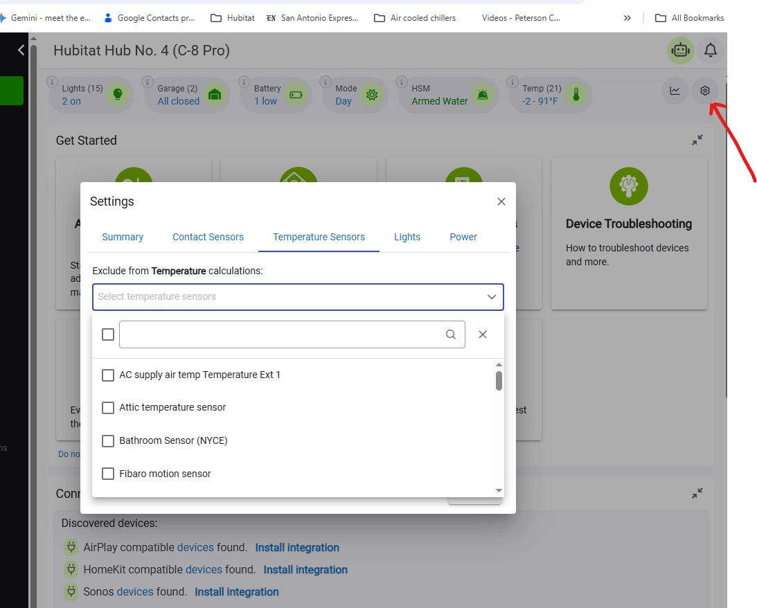

Click on the settings (gear) icon at the top right of the home page. Then click on the “Leak” heading.
Unfortunately, there is no “Leak” heading. The way you can customize the other categories is great but I do not see the same ability for leak sensors.
OK, then I am at a loss.

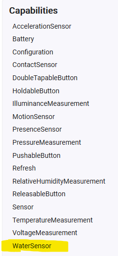

If I look at the Capabilities on all of these devices, they do all say WaterSensorplus a lot of other crazy stuff.
This is the Aqara tilt sensor. It is absolutely not a water sensor nor illuminance, presence, pressure… I don’t even think it’s a button.
This is the Ecowitt air quality sensor, it is definitely not capturing pressure, UV, leaks, illuminance…
But since they all report WaterSensor I guess Hubitat is not wrong for putting them in the list – but it sure would be nice if we could customize the leak detector list as we can for some other categories.

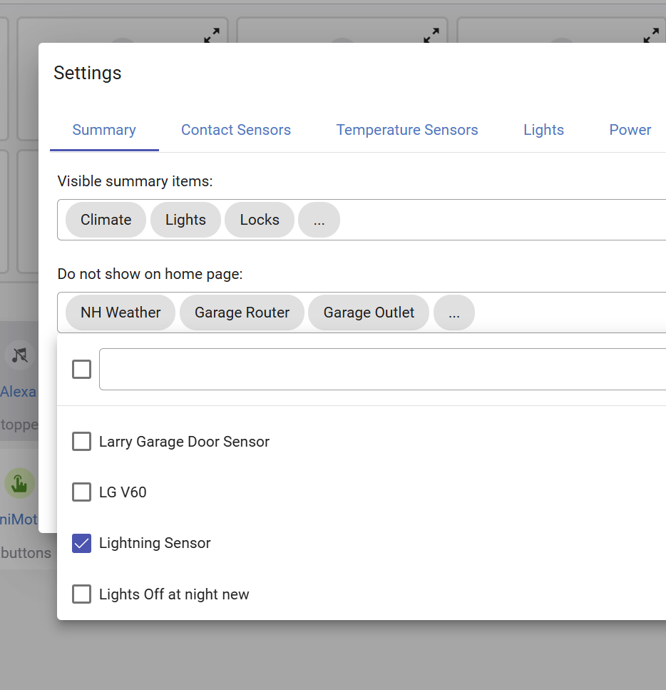

yes you can. on each ecowitt device that is not a leak sensor untoggle the option to show on home page under its preferences.

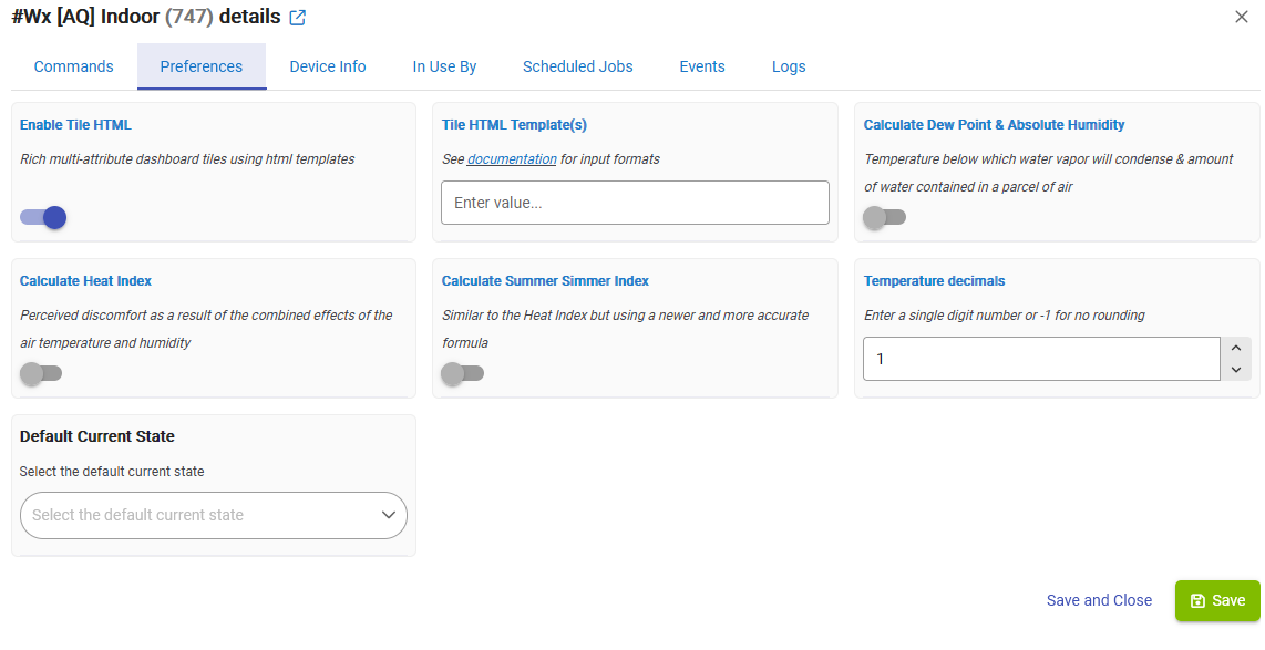

I am not trying to be argumentative, haha… But nowhere in the device info can I find anything about the home page visibility. This is the Prefs tab for an Ecowitt air quality sensor, I searched every other tab and did not find anything relevant.
If I am missing something, please spell it out for me!

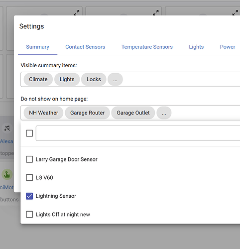

Probably just that you're on an older platform version? :slight_smile:
The “do not show on home page” option in that panel will hide any device from the home page, but across all categories. That’s too heavy-handed. I do have Ecowitt temperature sensors that should be listed in this home page summary.
What I want to do, remove specific Ecowitt sensors from the leak detector category only, seems to not be possible currently.
