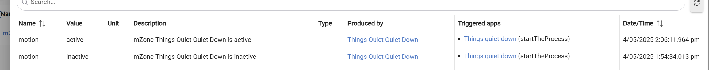

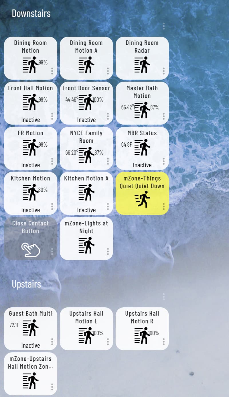

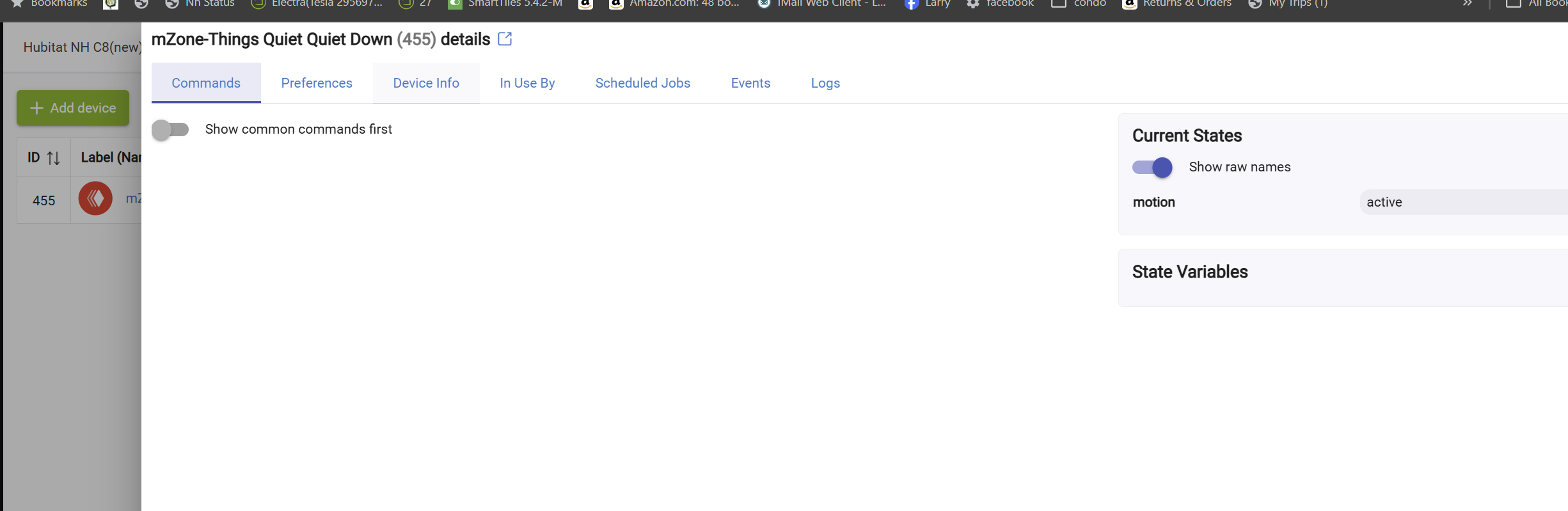

maybe something else is going on notice here the zone is active..
the sensor that triggered is already innactive..

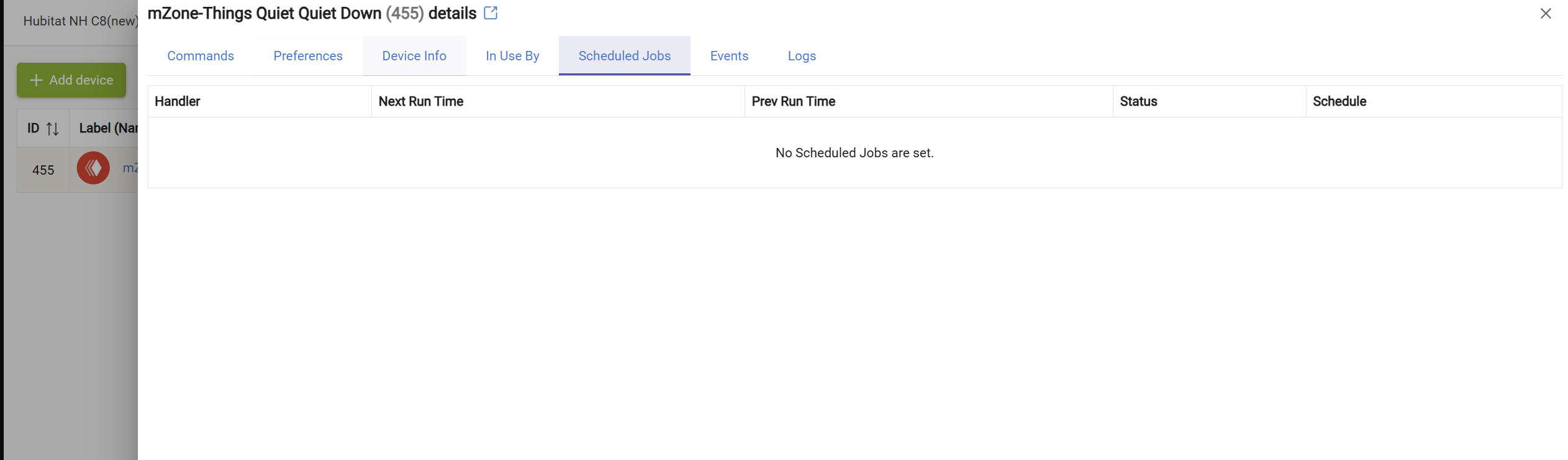

but there is no scheduled job to retest at the 10 minute cool down time?
notice everything but thqt zone is now innactive but there is no scheduled job for the timeout period
on that zone.
