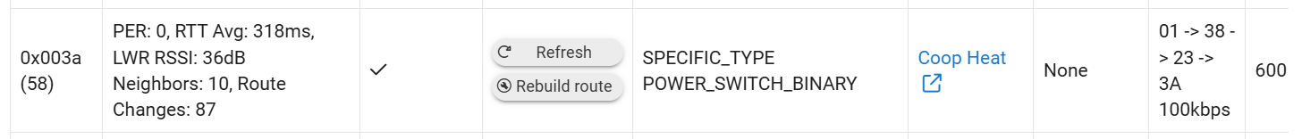

Today, things seem to be normal. While looking around under the hood, I did a refresh statistics then refresh page today. Everything looked "okay", but these devices caught my attention. They are in a building about 150 feet from the hub with a repeater about half way (which I have really never noticed them going through). I don't have any problems with them that I know of, but the devices in red have very high CHANGES. The device in green has none. All 4 are in the same building about 3 feet apart. 77 changes with 9 neighbors seems to indicate a lot of bouncing around... Thoughts???
The three switches show a strong connection but the route changes do look quite high.
Are all four switches the same device? What are they (brand/model)?.
Neither of these types of reboots will help directly with radio issues, which your symptoms may indicate. To clear your Z-Wave or Zigbee radios you need to shut down, pull power, wait 30s, then restore power. If that helps (and usually does) that means your Z-Wave radio/some devices got into a bad connection state. After the reboot you can keep an eye on things and see what kinds of routes the switches take and if they continue to have response issues and high route changes.
If the shut down/reboot doesn't resolve issues you can try a "Rebuild route" on each of the switches w/the high route changes and see if that helps.
“Refresh” after each rebuild completes to see how it worked.

Did that as step 3 above. The refresh screenshot above was today, after those 3 steps yesterday.
This was after the reboot...

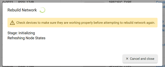

Will give it a try...
Will add to the process...

Ah, OK, so that's not so good. Just curious, how long after the shut-down/reboot was the screen shot taken?
Have to see how the rebuilds affect things...you might end up needing additional repeaters for the three devices if they continue to change routes at a high rate and don't have good performance.
Maybe teaching them how to UPS stuff to me would be a fun project? :wink:
Did those steps last night around 8/9 PM. Those were from today, about 12/13 hours later.
Working on it... Keep in mind.... over a period of months, I have moved the 2 repeaters and left them for a couple of months. Those far devices have never gone through them even if I put them withing 10 feet of the coop. I've really never had any issues with those devices, it's just the high number of changes caught my attention today. If I click a button I can watch it work nearly instantly on a camera up there. The changes are puzzling as I've never seen that before...
BEFORE:
REBUILD:
THEN:
AFTER REFRESH:
AFTER REFRESH STATISTICS:
30 SECONDS REFRESH PAGE:
We started with 87 changes, now 91. :thinking:
Up to 105 changes.... :worried:
Large number of route changes usually indicates the device isn't happy w/the routes it has availble to it. Given the connection speeds are 100, seems a little odd.
