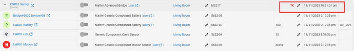

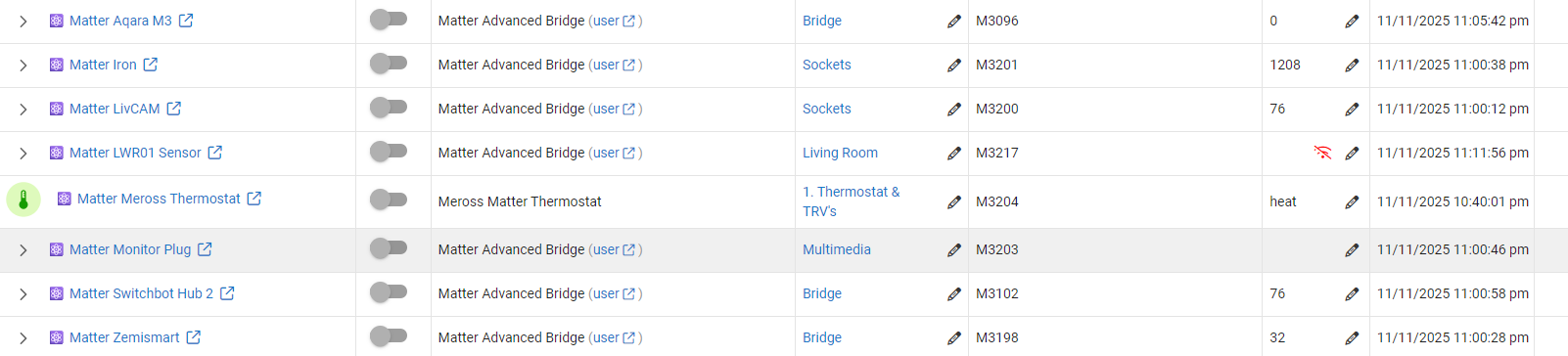

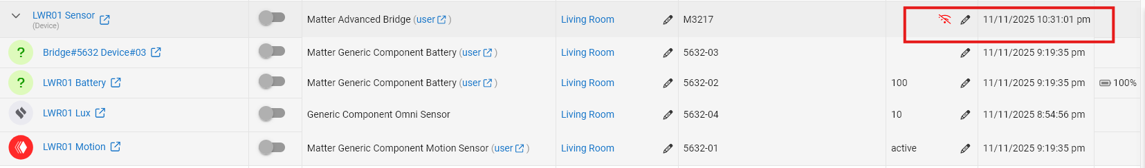

You can use the community "Matter Advanced Bridge" driver and you should get child devices for motion and illuminance (not sure about battery level).
Example below showing the Meross Smart Presence Sensor (wired):
Does it not need a Thread border router then as mentioned above?

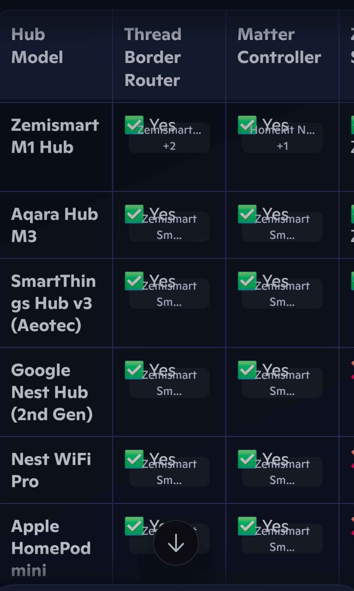

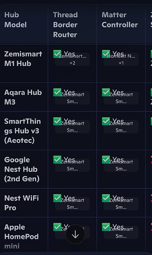

It states that it does, then I guess we have to first commission the device using any of the following hubs in the screenshot, then generate a matter code for use in Hubitat. I normally use SmartThings, Aqara M3, or Zemismart M1 hub.

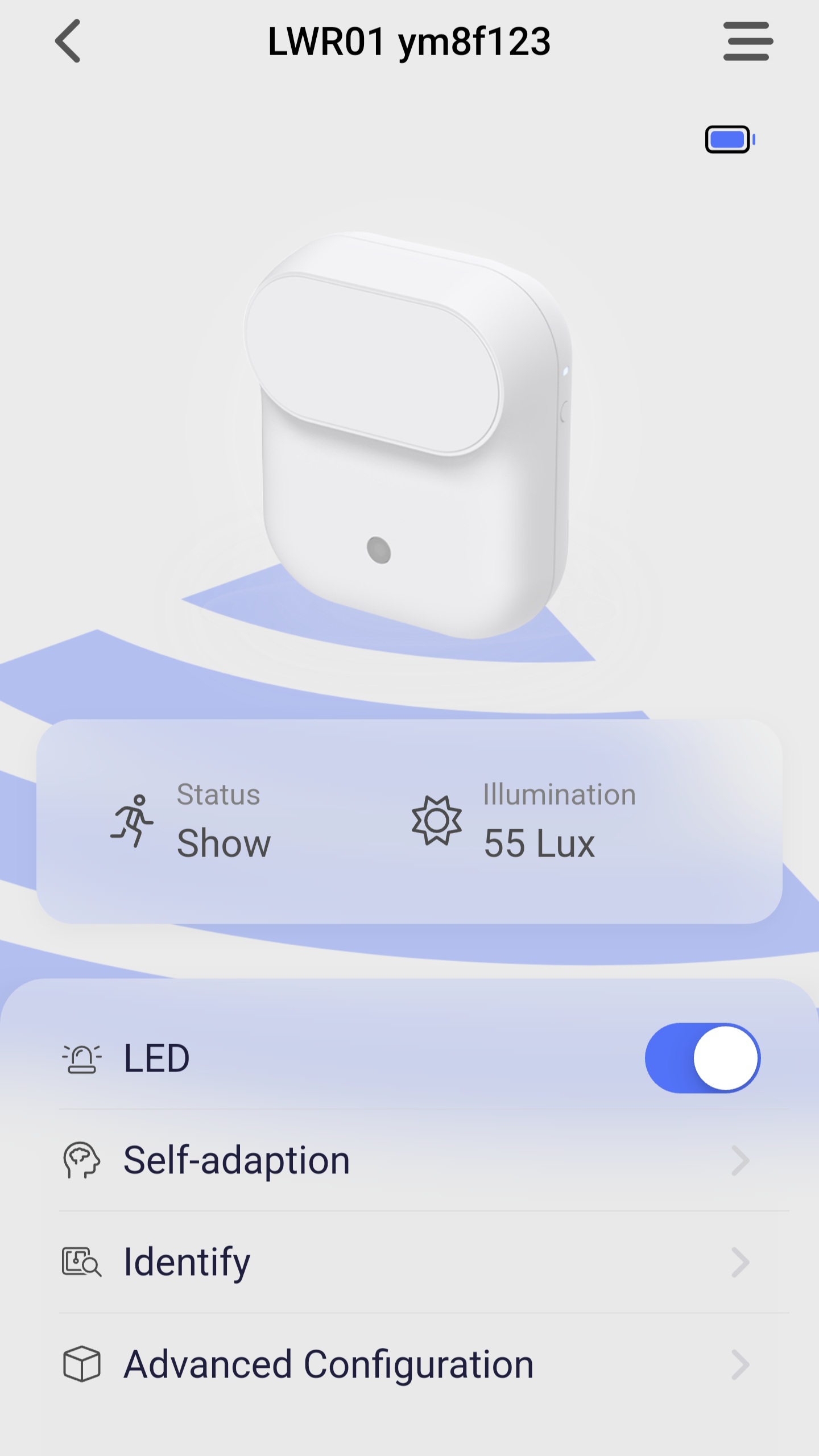

I have now received this device and I am quite impressed, just wish I waited a bit longer as Aqara FP300 has just been released!
Paired it to Aqara M3 hub via Matter thread.
Then generated code to share to other ecosystem, including Hubitat.

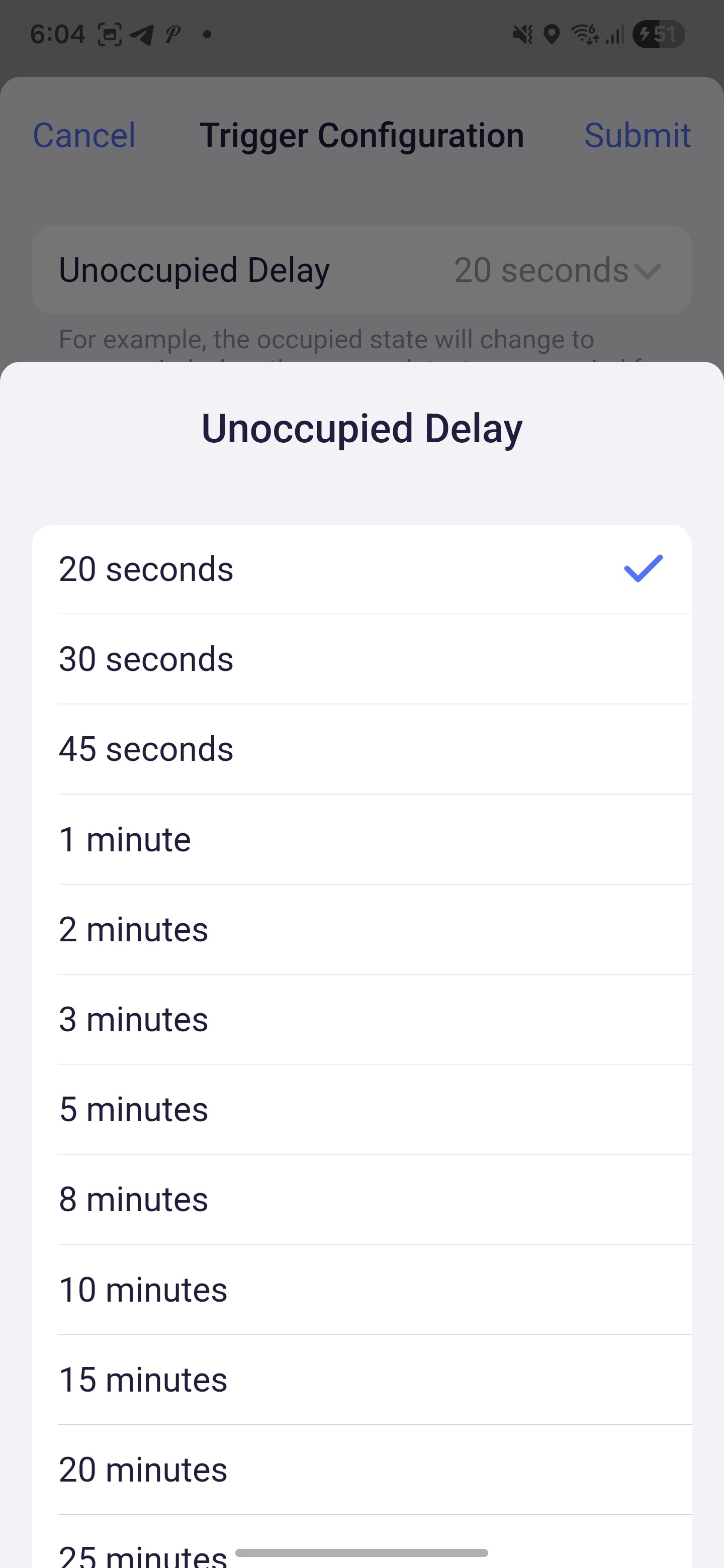

Presence detection seems to be really good, has a default min timeout of 20 seconds though, which is pretty high for my liking.
Negative for me is that the sensor is pretty big and device settings can only be accessed locally, which is annoying.

Bring your M3 hub into Hubitat via matter and the sensor may come over as a child device to the hub. If so it will be connected to the M3 but controlled by Hubitat. That is if Aqara makes the sensor available that way. Worth a quick try.
Yes, already have several hubs added to Hubitat via Matter Bridge driver!
Unfortunately, Matter Bridges only expose supported non-Matter ZigBee devices to Hubitat, and Matter devices i.e. LWR01 need to be added separately.
I had no experience with this actual device so that is what I was concerned about. Some of the Aqara zigbee devices still don't come over via matter. It was worth a shot.
