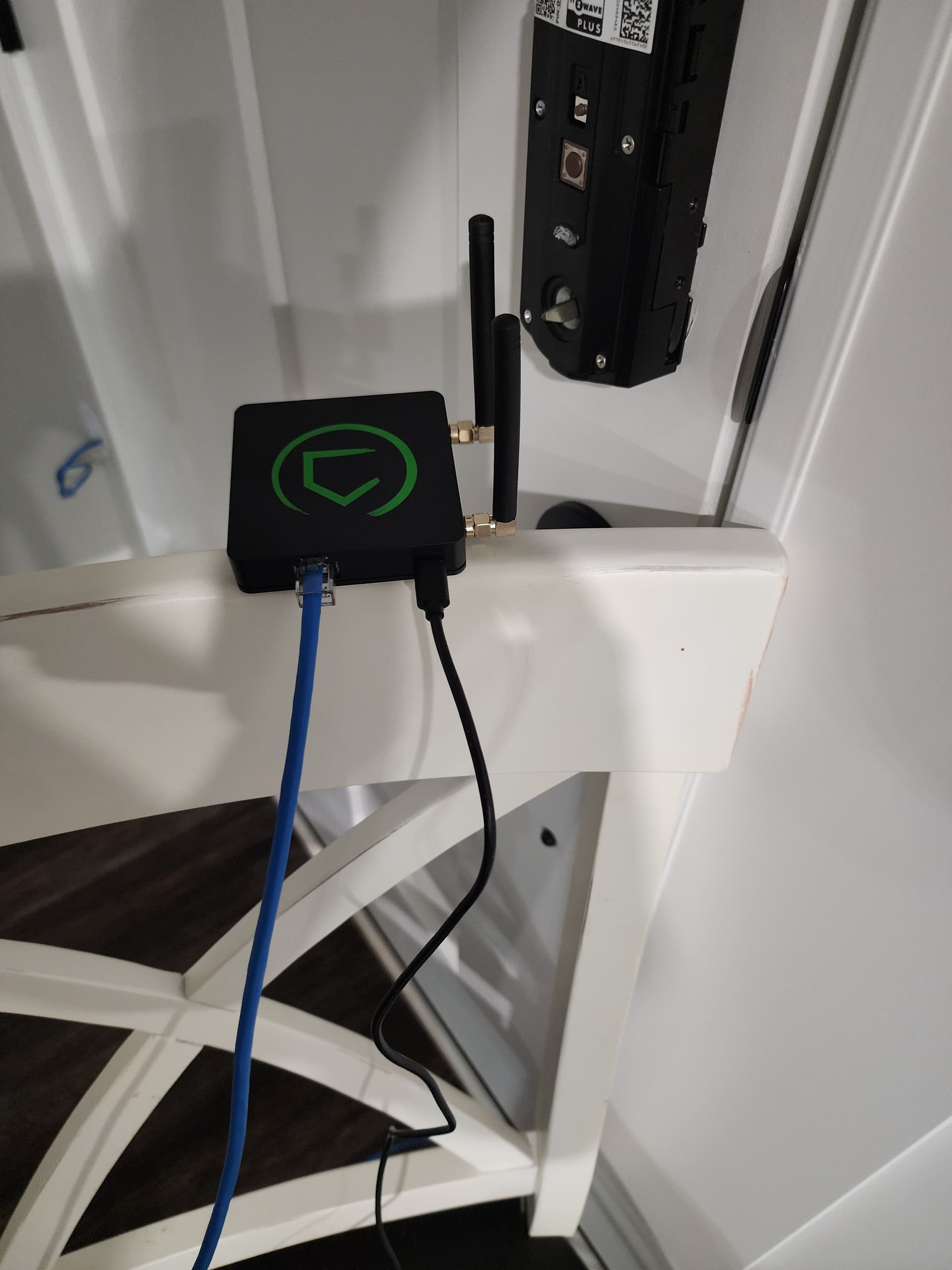

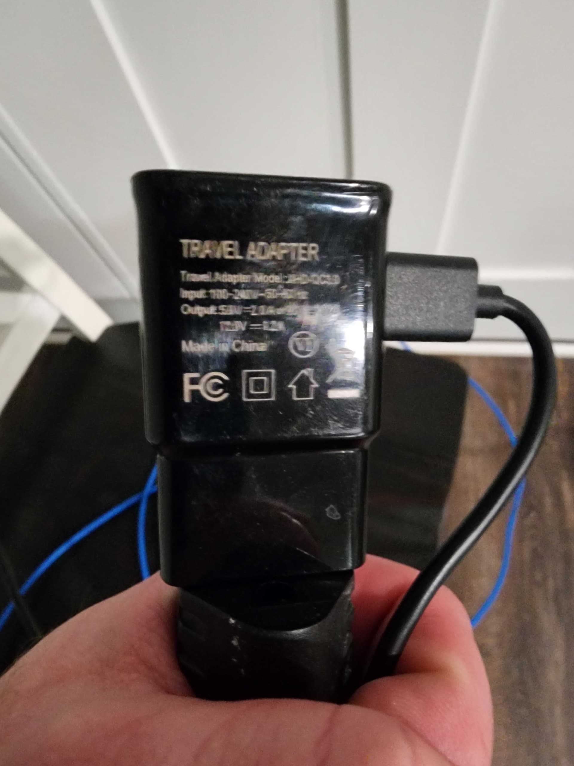

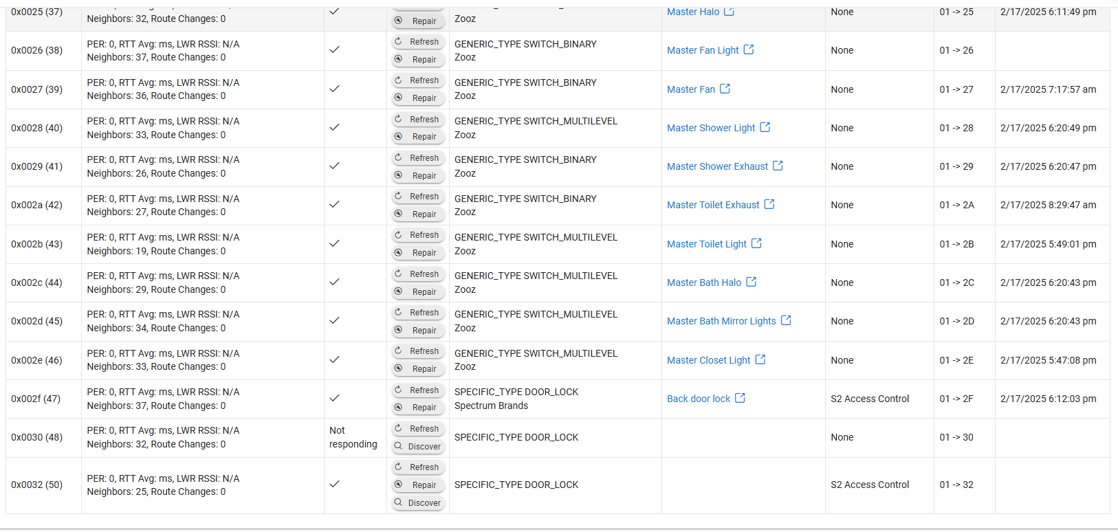

I have these kwikset locks and a brand new c-8 pro. The link says 914 and the paperwork inside says 620. 46 zooz switches and the first lock paired with no issues. Second one started to pair and then froze up. Now I think I have what's referred to as a ghost. I have reset the lock at least 10x. I've rebooted the hub, left it unplugged, batteries out of the lock, excluded over and over, spammed refresh, etc. The hub is hardwired and within a foot of the lock. I''m not 100% sure if it's the orignal power block because I don't remember what it looks like, BUT i set this up when my house was completely empty and it's the only option I had at the time and don't know why I would have changed it. I'll attach a picture.

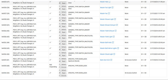

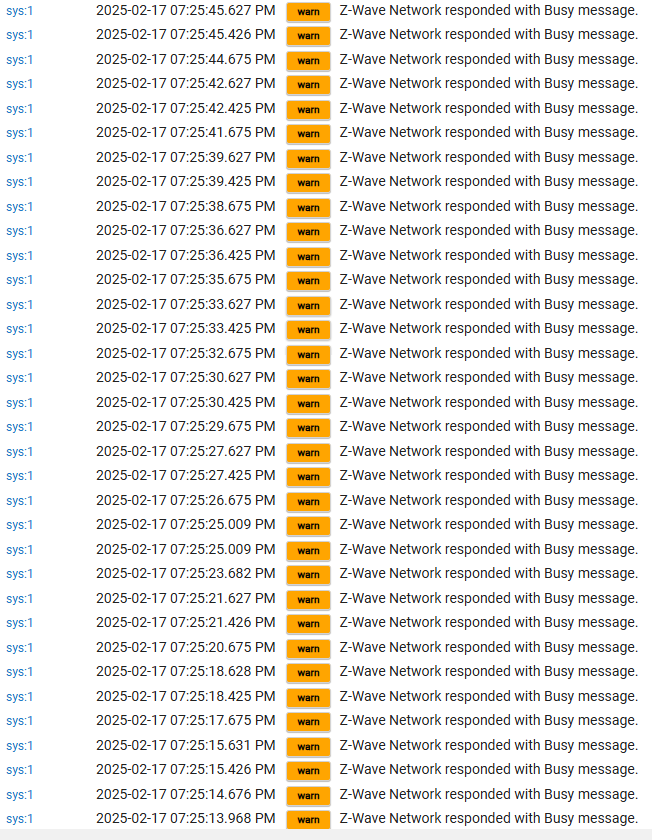

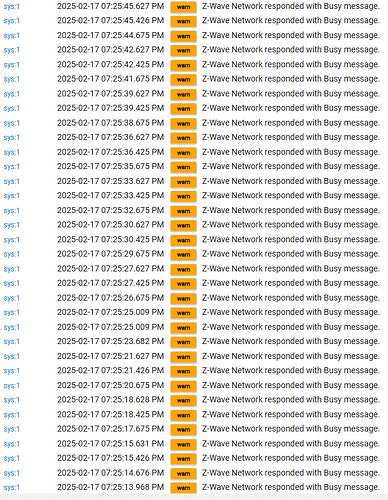

Edit: finally got it to start inclusion again last night after resetting and restoring. It timed out again and I now have 2 ghosts and the entire zwave network is unresponsive for controls. I am getting updates when manually turning switches on and off. "Z-wave network responded with Busy message" is any time I try to control something via the hub.

You can try to remove those ghost nodes using the built in hub tools, instructions are here: How To Remove Ghosts using hub tools or a UZB Stick
Seems like you may need to do this before you go any further. If its going into that busy state right after booting up, something is spamming the mesh. Do you still have the batteries in the lock(s)?

I've read that and I ordered a zwave stick last night but it won't be here for another day or two.

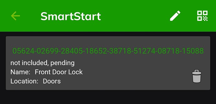

I tried using SmartStart and let it sit for 24 hours and it never left this state.

Possibly not, for some reason ghosts from locks cause extra havoc.

If you remove the SmartStart entry and pull the batteries out of any unpaired locks you may have a functional system for now.

This in itself will usually lock the radio and cause the busy error, which you then need to do the shut down dance to get it back again.
Yes you will need to use the stick if you want to remove those.

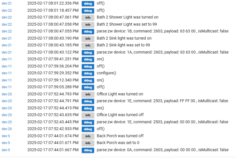

Well, I thought I had a temporarily functional system. I only tried the room I was in and it worked. Tried my living room and it's the same as before.
The top on/off attempts are via the hub trying to turn the bathroom lights off that were just manually turned on. The Ones at 7:59 were a diff room that are currently off, but were showing on in the app.
And now the room I'm in that worked a few minutes after the shutdown no longer works. I'm assuming this is because I clicked refresh ONCE on the lock
Probably, stop touching it.

zooz zwave stick came in today. after a lot of attempts I finallyu got both ghosts (same lock) removed. Added the lock on first attempt with no issues. Will this zwave stick cause issues on the hub as a ghost? It never paired as device. Just shows up in details.
No not really but you can also exclude it, Put hub into exclusion mode, In PC Controller click Select Learn Mode then NWE. It should exclude pretty quick.
