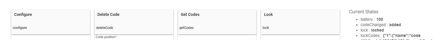

I had some struggles getting my kwikset lock working, I had this working on friday, Via the app to test I can click lock and unlock and it worked.
Now today it's not. I had 2 rules set and I tried each and neither worked, which was simple, door unlock, turn on a light between a certain time. this was a setup I had in wink and worked well except for their delays at times.
  1. Is it because I moved the hub back to the location of choice? because the only way to get this back on was to have the hub next to the lock and that's how I got it to work. My hub is in my basement, the lock is on the 1st floor, I have lights going through the hub on the 1st floor also and they work.
In the 3rd image I highlighted the date/time, I'm not sure if that's because I was changing to different drivers where sometimes it gave me a Fake "unlock" since nothing happened but I did that to see if the device "Generic Zwave lock" just needed to be refreshed, but once it was back to that and I tried to unlock, nothing happens.
