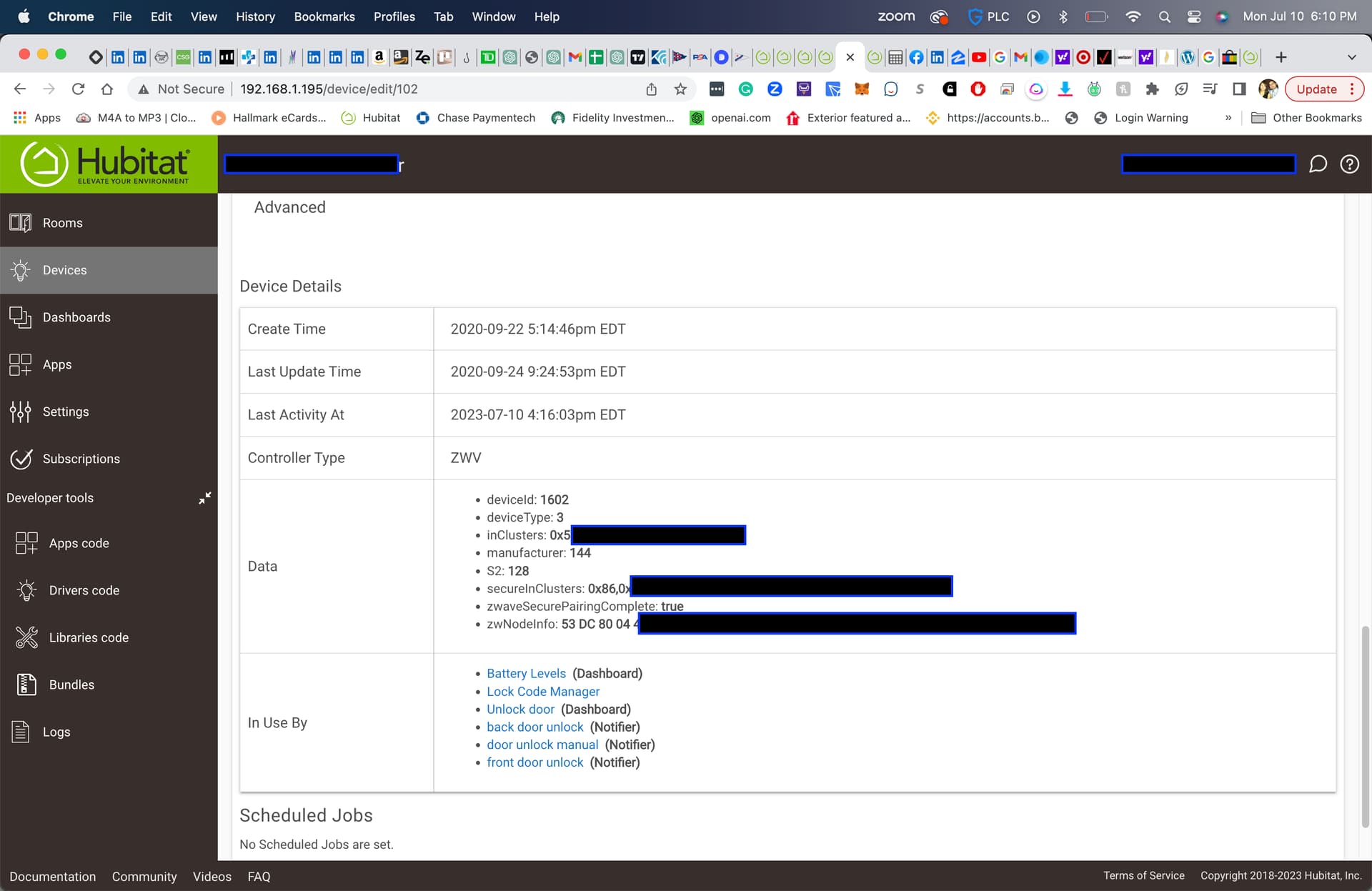

I did compare the two and see under Device- Data grid one has a device type 3 (one that works perfectly) and the other has a device type 1 (doesn't work exact). I was wondering if that is the issue and how to change it.

Thanks for the response! I have tried numerous times. Is there a way to change the device type shown in the attached pic to be the same? Or force it to be same. Pic of both front and back.
