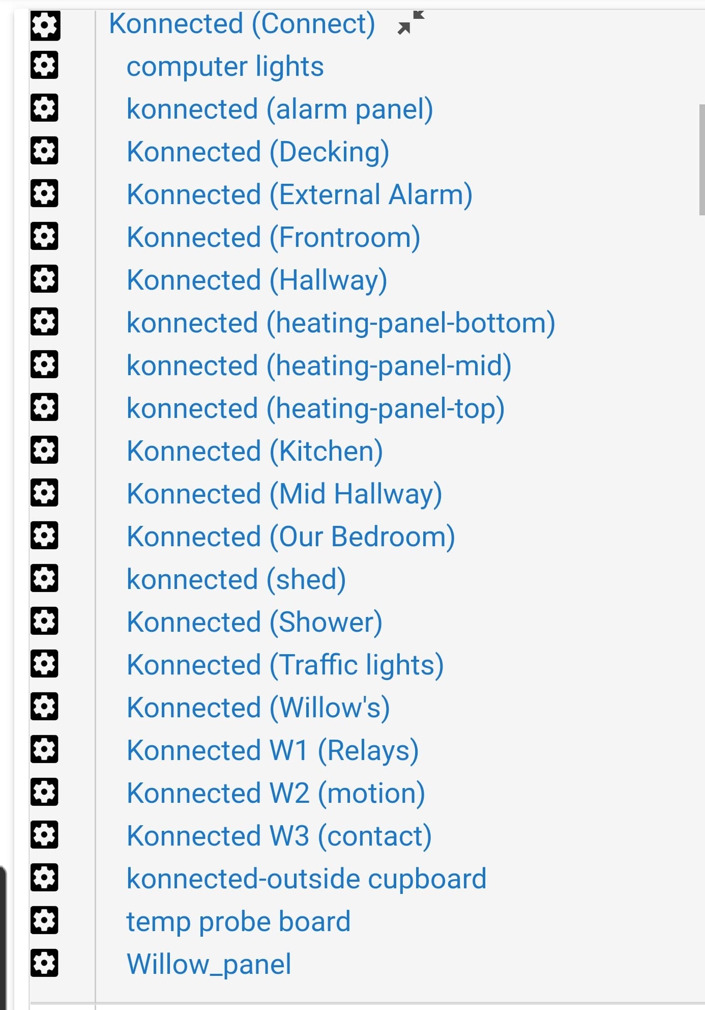

Bear in mind that you can add a relay to control virtually anything too. Ideas are limitless.
  • Smart central heating (dry contact for boiler, dht22 temp/humidity sensor, AC actuators for rads via relay)
  • Sirens and alarm boxes
  • Control panels with lights and push buttons
  • Contact sensors, 12v pirs
  • External AC Pir's via relays
  • hot tub controls
  • 12v control panels, fob access
  • Led lighting controls merged with wled (I have a button on the side of my computer shelf to toggle lighting)
  • garage door control via relay
Literally anything.
