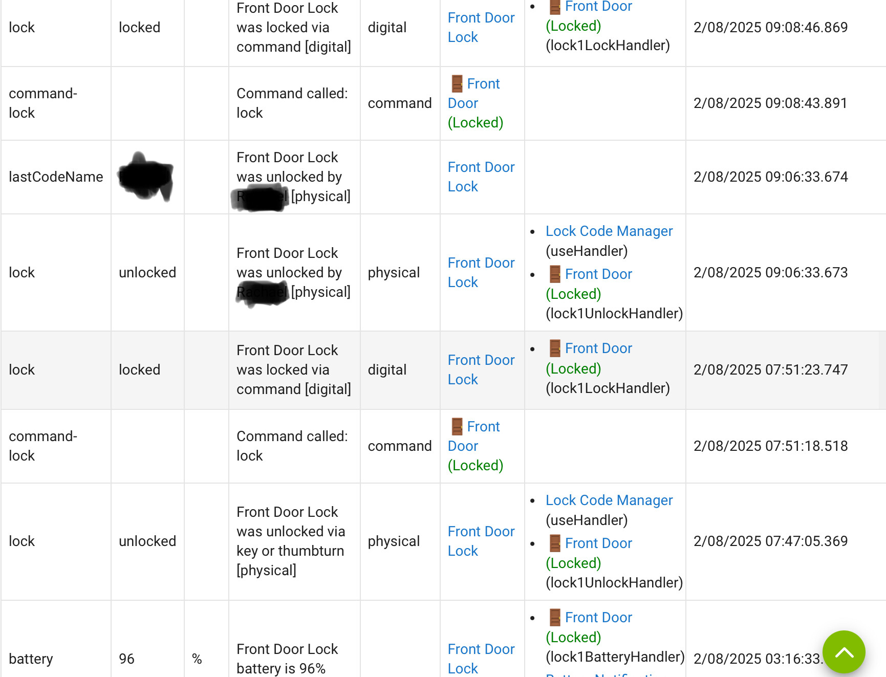

Not too sure if this is what you are after, I have a Yale assure lock with the zigbee module, and in the events I can the different ways the door has been unlocked - pic below
Thanks! And can you create rules based on this? (I ordered my Hubitat, but don't have it yet)
This depends on the lock. The majority of locks that integrate directly with Hubitat can provide much more than state (locked/unlocked). They can provide information whether the lock was unlocked digitally or physically (thumbturn used). For a digital unlock, the user code/name used to unlock will also be provided.
