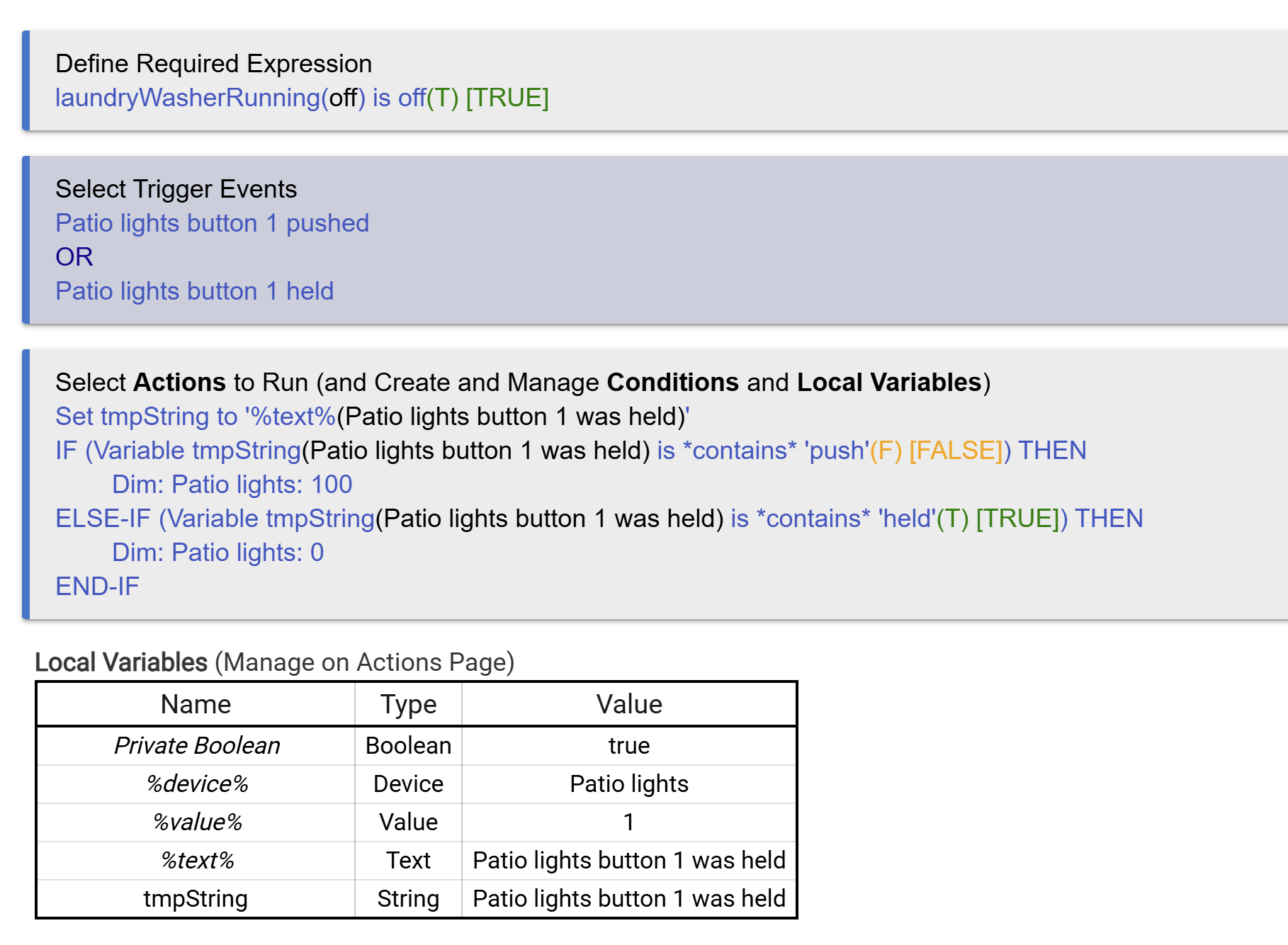

It doesn't look like you can pause buttons configured via Button Controller but if you reprogrammed your switches using either Room Lighting or Rule Machine then you can create another rule that will disable whichever rules (buttons) you choose when a virtual device is on.

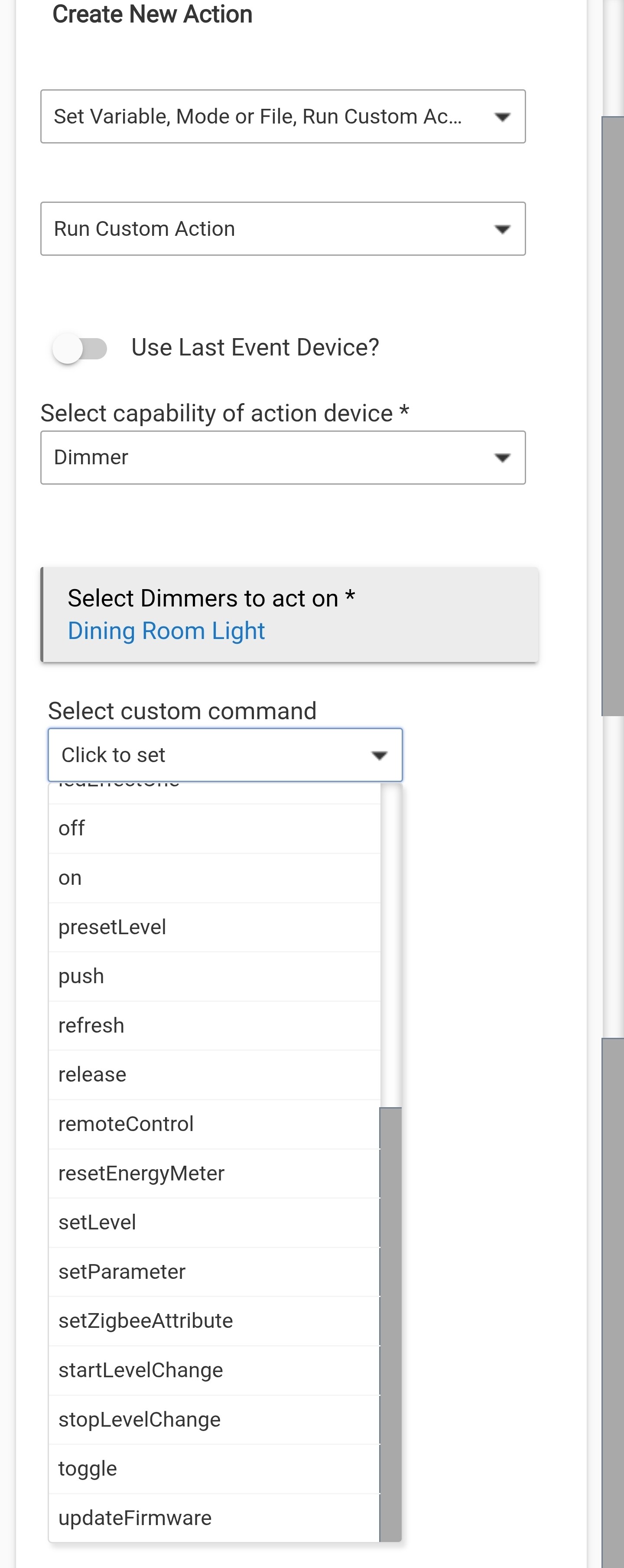

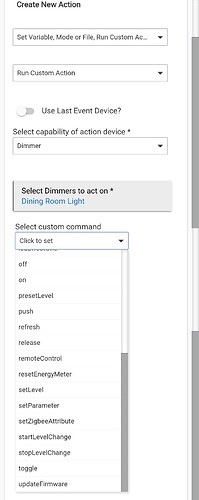

Another thing to try would be to create a rule that runs a custom action on your inovelli switches and see if disabling remoteControl kills the switch functions.

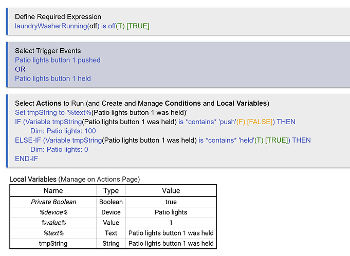

Consider moving the button controller logic into a new Rule Machine rule and define the virtual switch you mentioned as a required expression (ON or OFF depending upon how you name it/think about it), e.g.:
// I used an existing virtual switch so ignore its name obviously :slight_smile:
Something like above ^^^ using a required expression based on a virtual switch is also the way I'd go. Then set up the virtual switch so you can turn it on/off via voice command (if you use smart speakers). You could also toggle the virtual swith for the required expression on/off using a virtual button (i.e, double-tap another light switch that allows you to define that as a button press), or use a real button to toggle the required expression virtual switch. Hopefully that's somewhat clear... :wink:
