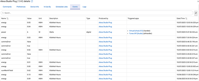

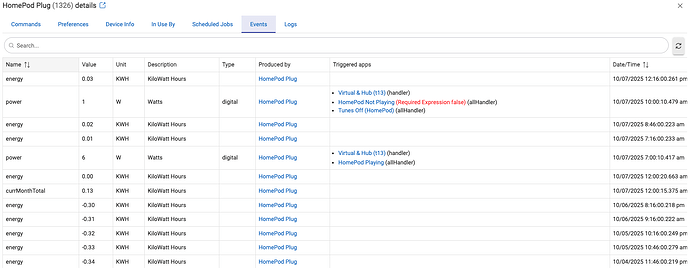

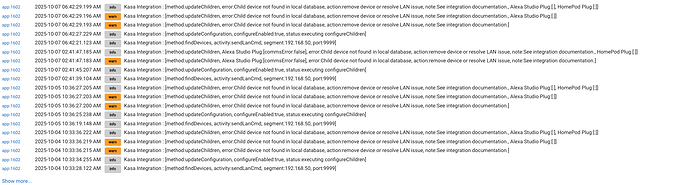

Getting this in the logs all of a sudden... no changes have been made...
The device is still reporting so I'm not sure what to make of the error.
You have two devices that are no longer discoverable by the Kasa App and therefore the app can not update the device data. This data is used to update Device IP as well as operational parameters. The plugs are the Alexa Studio Plug and the Home Pod Plug.

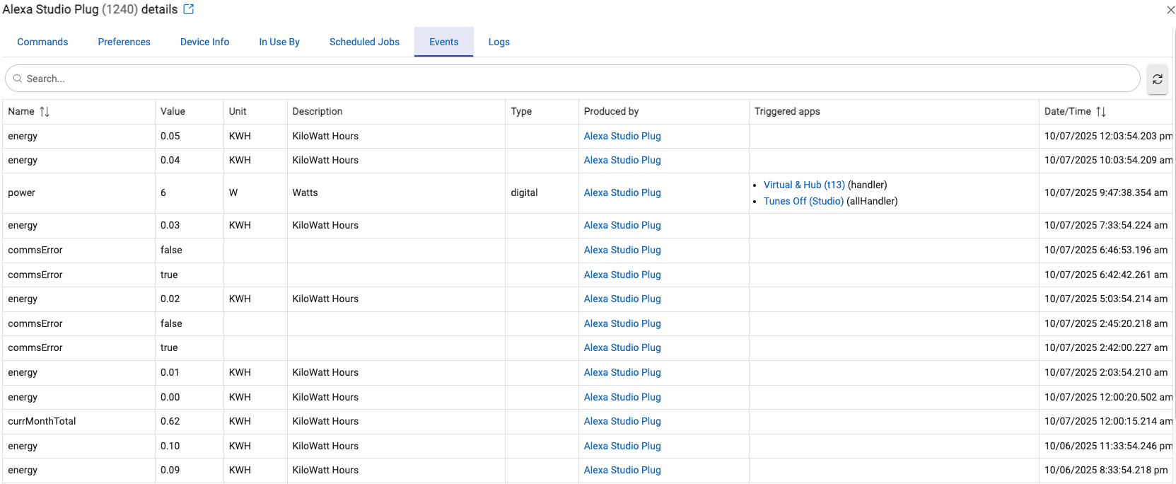

Ya they are both reporting data....
That's why I don't get the error messages.
Error message can occur for several reasons.
a. Device was otherwise busy when the poll was received and it ignored the poll (unlikely in this case).
b. Device was not in the defined IP range set in the Hubitat Kasa Integration App. Check IP addresses versus setup of startup page of the App. If your devices are on a different segment than your hub, then this will have to be modified.
c. You router temporarily put the device to sleep (not on the list of devices - I have seen this when I had more than 30 devices on my router. Added a bridge to handle additional devices).
They are static IP's for those devices. I'll just ignore it unless the frequency increases. Thanks.
