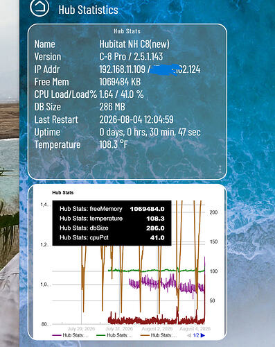

Just upgraded c8 pro to 2.5.1.143 high cpu load still after 1/2 hr
@gopher.ny

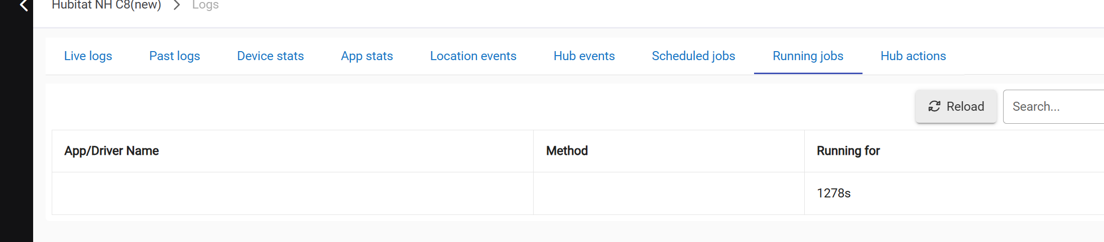

no errors in logs and nothing of not except one unnamed process in hub processes continually running.
The database looks kind of big. Maybe reduce the event and/or device attribute history retention numbers, at least for the devices that you don't care to have the history for?
already did that it has always been around 300 .. thats not the issue as it was ok on last build.. wonder what process is continually running

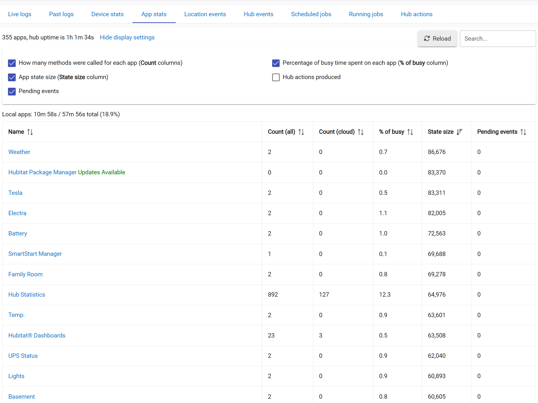

also looking at it it appears the dashboards themselves are taking up most of th eroom.. any way to reduce it..
Are these cloud dashboards that are accessed from elsewhere?
those are legacy dashboards that have both a normal and cloud link but nothing is regularly accessing them..
