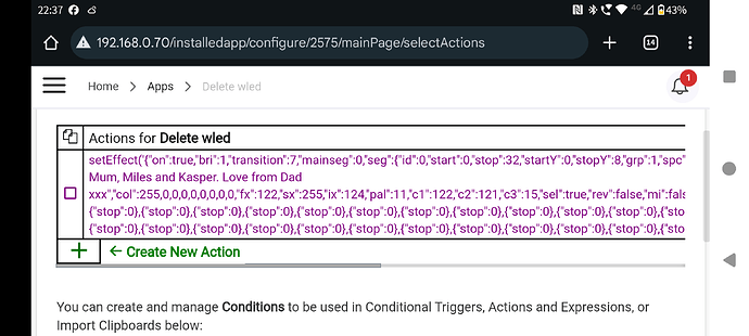

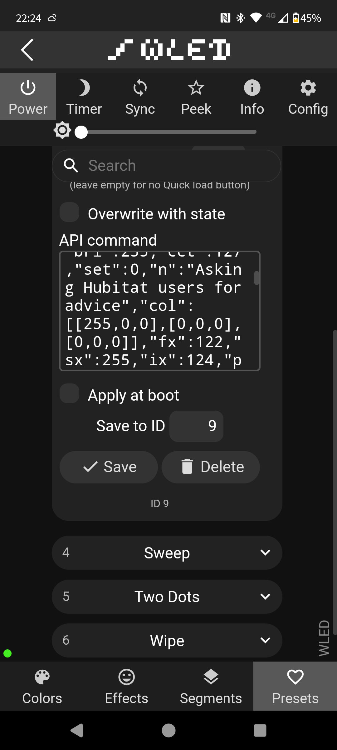

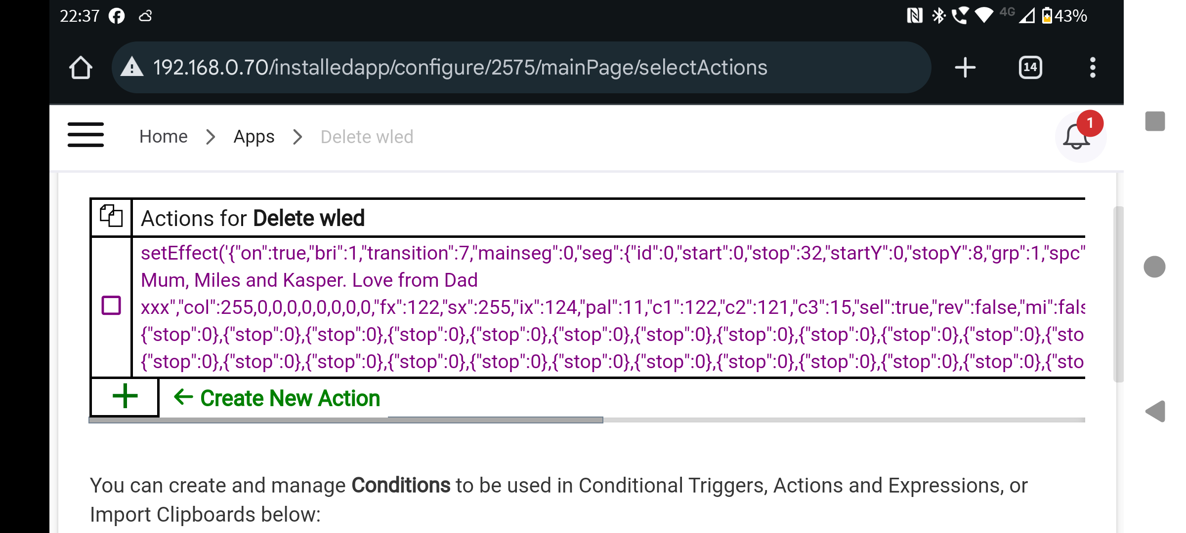

So I've worked out how to initiate a WLED preset via Hubitat using @joyfulhouse driver.
I love the scrolling text feature of this app but the nominated text is defined within the presets section of WLED. Is there a way to pass a variable into the text so that the text can vary. I.e passing a custom command with defined script.
So is there a way to pass the nominated text from HE to WLED as a custom command somehow.
I've looked at custom commands, but hit the wall so far. I'm confident this is possible but just require a few pointers.. appreciated in advance.
EDIT - for clarity, I'm asking for a way to display text on a RGB digital panel on the fly from Hubitat rather than pre defined text within the WLED app.
Appreciated in advance :slight_smile:
{"on":true,"bri":1,"transition":7,"mainseg":0,"seg":[{"id":0,"start":0,"stop":32,"startY":0,"stopY":8,"grp":1,"spc":0,"of":0,"on":true,"frz":false,"bri":255,"cct":127,"set":0,"n":"Asking Hubitat users for advice","col":[[255,0,0],[0,0,0],[0,0,0]],"fx":122,"sx":255,"ix":124,"pal":11,"c1":122,"c2":121,"c3":15,"sel":true,"rev":false,"mi":false,"rY":false,"mY":false,"tp":false,"o1":false,"o2":false,"o3":false,"si":0,"m12":0},{"stop":0},{"stop":0},{"stop":0},{"stop":0},{"stop":0},{"stop":0},{"stop":0},{"stop":0},{"stop":0},{"stop":0},{"stop":0},{"stop":0},{"stop":0},{"stop":0},{"stop":0},{"stop":0},{"stop":0},{"stop":0},{"stop":0},{"stop":0},{"stop":0},{"stop":0},{"stop":0},{"stop":0},{"stop":0},{"stop":0},{"stop":0},{"stop":0},{"stop":0},{"stop":0},{"stop":0}]}
