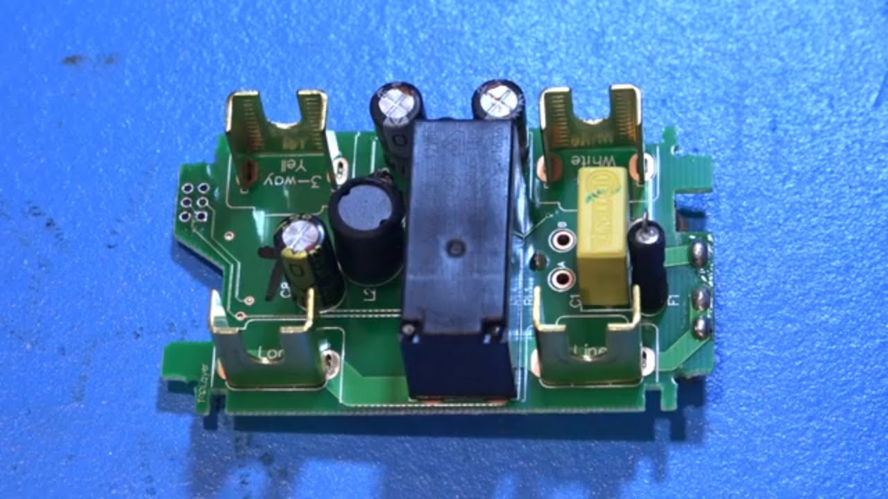

It should also be mentioned, there is a way to fix them yourself if you are good with soldering... I figure I'll have to go that route if any more fail outside of the 5 year warranty window...
