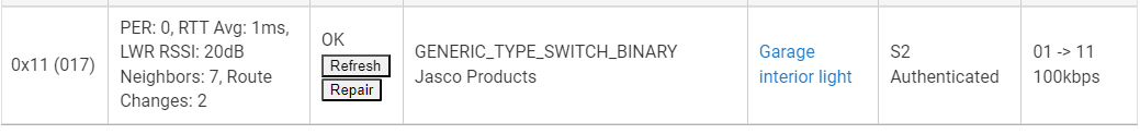

If that doesn't work, post a screen-shot of the dimmer from your Z-Wave Details page (Settings>Z-Wave Details) - will look something like this:

Z-Wave details of device
You have a switch, not a dimmer (...SWITCH_BINARY... means switch). A dimmer would say "MULTILEVEL" like below):
So change the driver to the Generic Z-Wave Plus Switch driver, so you have the correct driver. After making that change hit the Configure button on the Device page (forgot to mention that previously) to apply the driver, and then try to turn the switch on/off from the Device page.
