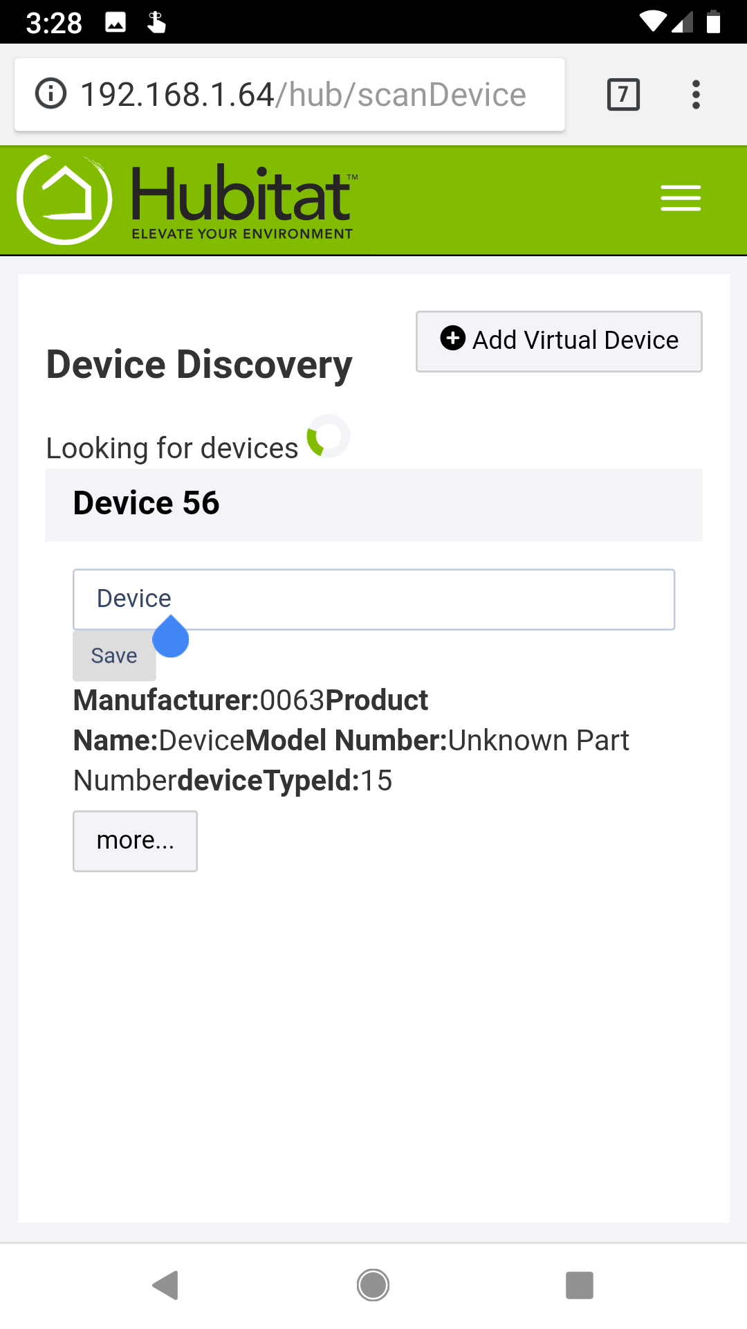

I have two of these. Strangely, one reports as intended, and the other doesn't. I tried resetting the device. It pairs like this:

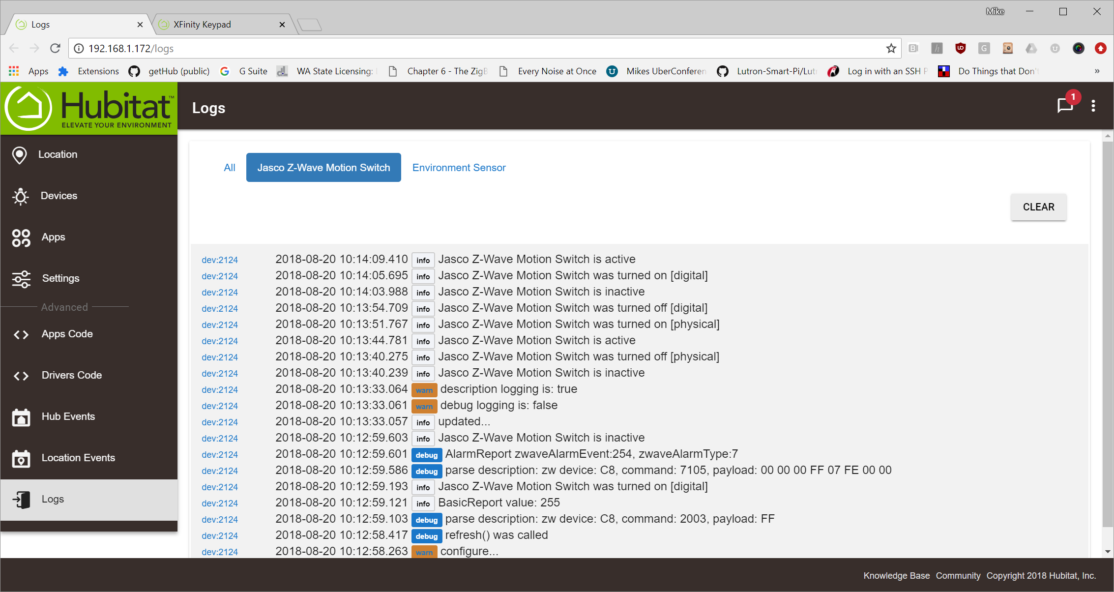

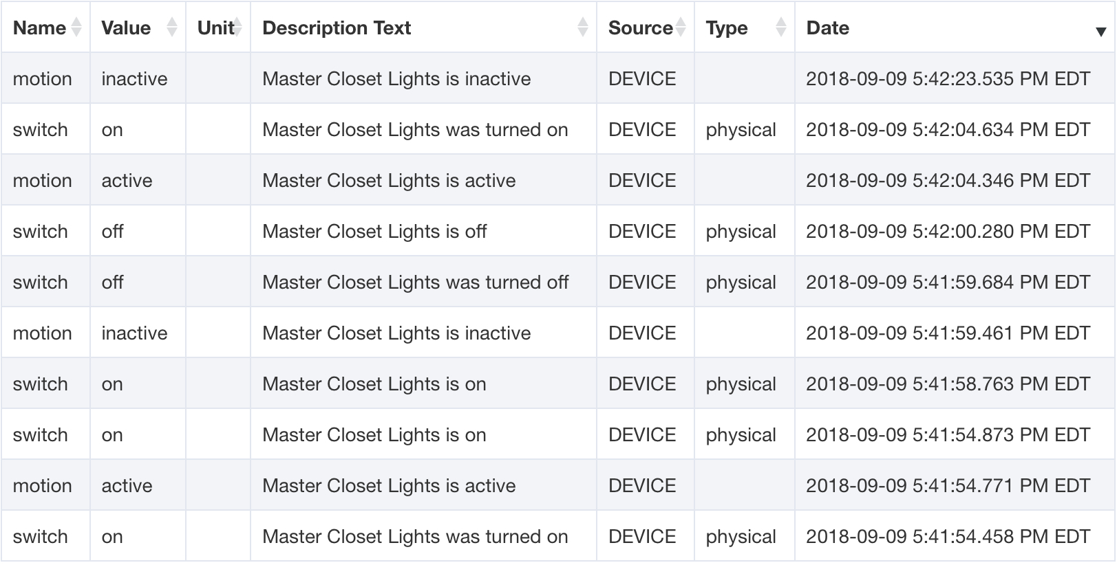

My motion on/off switch log events just fine: motion, physical, and virtual.
