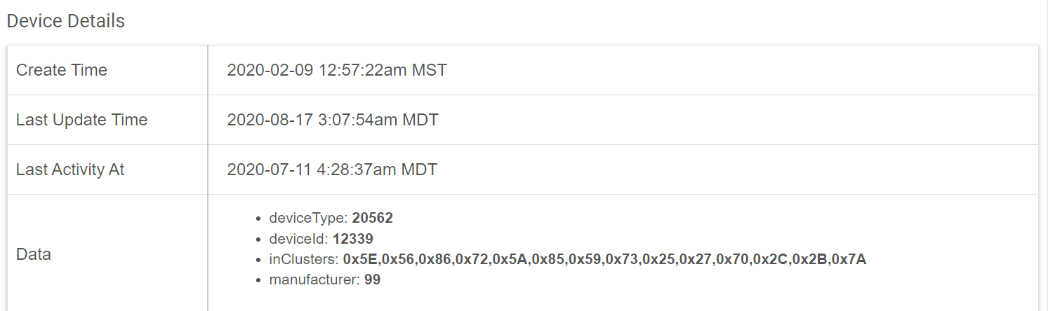

Can you post what it's showing in the Data section of Device Details on the Devices Page, should look something like:
And a little further down, what driver is listed under Type:
Thanks - so I have a couple of these and here's what they show:
Data1:
deviceType: 20304
inClusters: 0x5E,0x25,0x85,0x59,0x86,0x72,0x55,0x5A,0x73,0x5B,0x9F,0x6C,0x70,0x2C,0x2B,0x22,0x7A
protocolVersion: 6.04
hardwareVersion: 255
firmwareVersion: 5.52
deviceId: 12340
manufacturer: 57
Type1: Jasco Z-Wave Dual Outlet
Data2:
deviceType: 20304
zwNodeInfo: D3 9C 00 04 10 01 5E 25 85 5C 59 86 72 55 5A 73 5B 9F 6C 70 2C 2B 22 7A 68 23
deviceId: 12340
manufacturer: 57
Type2: (same)
