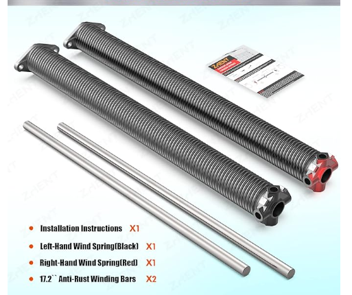

These are the springs I refer to.. which slide onto the jackshaft itself.
Screenshot 2024-07-15 at 12.51.34 PM
They join above and in the center of the door.

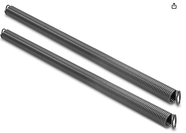

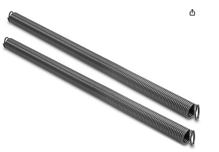

If the installation you're investigating uses the "old fashioned" springs that are on the left and right outside edges of the doors, then yea, the safety went way up. :smiley:
Screenshot 2024-07-15 at 12.53.35 PM
Yep those are the ones I have. They were replaced a few years back because one popped.
Those side mount ones are scary.
If the picture below is what you're talking about I've replaced several over the years myself when they broke. No big deal.
