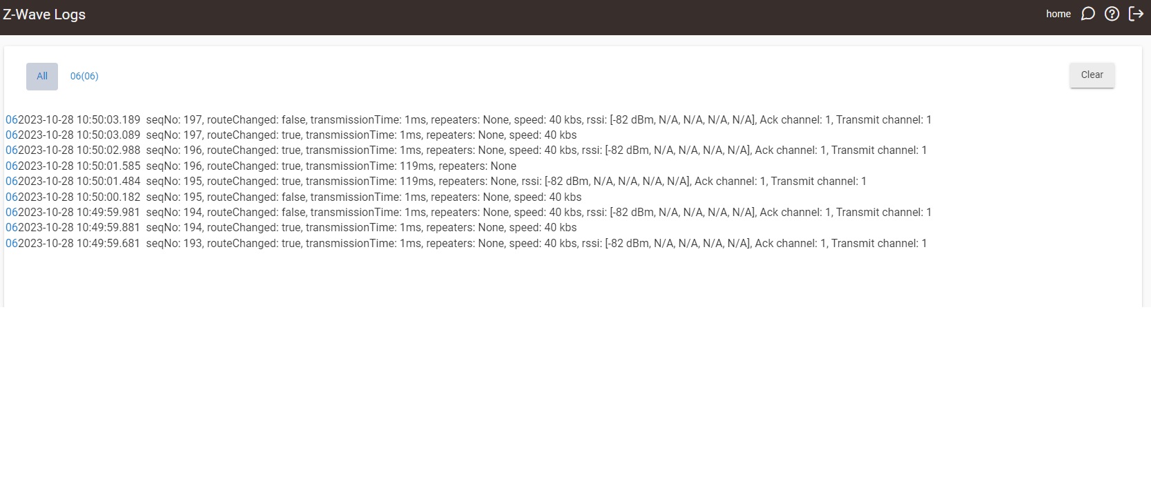

Z-Wave Repair
Stage: Idle
Finished Z-Wave Network Repair
Failed Nodes: 06

It's not paired. Remove it, run exclude, factory reset the lock and try again. Preferably within 2 feet of the hub. (move hub to lock or lock to hub). Also prior to re pairing, can you click the firmware update button at the top of your z-wave details page to update your z-wave stack? Also locks require security.

What's your z-wave details page look like now?
