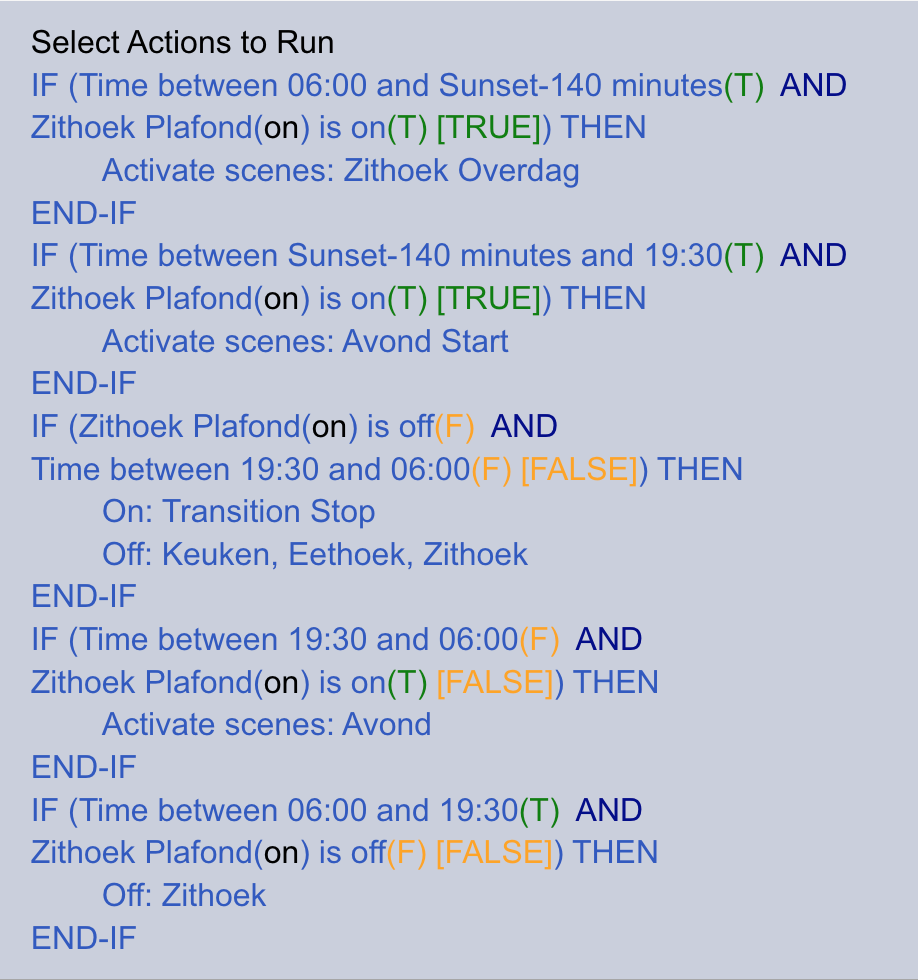

Recently I'm having trouble with some rules and timed actions.
This rule had been working for over a year and recently it stopped working properly. As you can see it should activate a certain scene during the daytime (0:600 and sunset-140) and another scene when the evening starts(sunset-140 and 19:30) but they are both set to TRUE. which is wrong because the current time on the hubitat is set to:

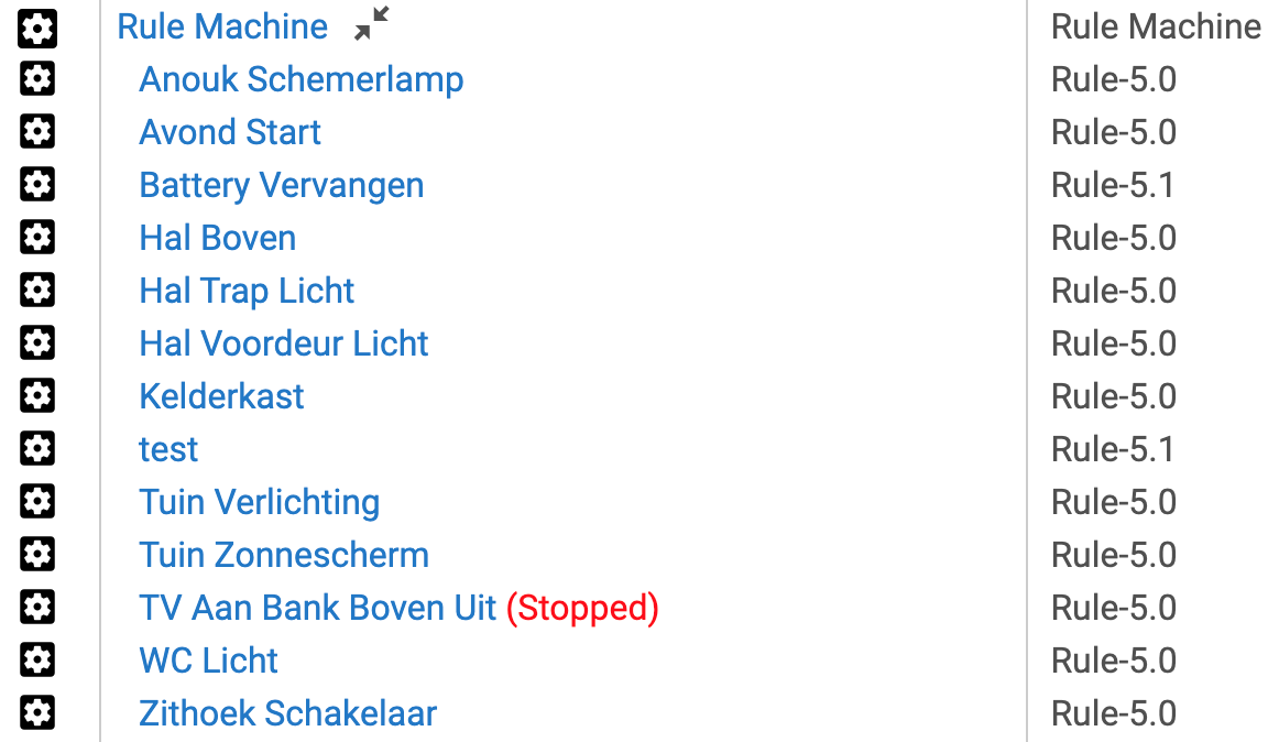

I'm using HE platform version 2.3.1.142 on hardware revision C-7 and RM Version 1.0.3 (2/28/2022) The type column shows "Rule-5.0" as shown below

As we approach the summer solstice, and sunset is later, I must ask-- What time is your sunset? Is it possible that the (sunset - 140) is after 19:30, in which case you'll run the second IF block rule pretty much most of the time?
@jpcurcio nailed it! Sunset was 21:51 so Sunset-140 minutes is 20:11. The second IF-THEN would evaluate as True from 20:11 until 19:30 the next day. It is possible that both evaluating True was correct.
@jpcurcio YES ! sunset is at 21:53 today. Damned, of course. I did not take that into account and feel stupid now ! In my defence just became a father for a second time so I have been on little sleep lately. Not the sharpest knife in the drawer atm lol.
Thanks a lot for the help all ! Good stuff
One other thing, if I may, regarding style. You have five single "if" statements, which means that every time this rule is triggered, it will execute them all. I find it much cleaner and easier to understand if these are done in a single, nested if-then-else statement (this also eliminates the need to do an AND in the Boolean check). This way, the most comparisons made will be three, and you won't have to test as much since the "else" is only run if the "if" fails. The other thing is that it can guarantee (with proper consideration) that the situation you saw here with sunset doesn't happen.
For instance, this would be my take on re-coding to avoid this situation... (any typos are mine!)
IF (Zithoek Palfond is on) THEN
  IF (Time between 19:30 and 06:00) THEN
    Activate scenes: Avond
  ELSE-IF (Time between 06:00 and Sunset-140 minutes) THEN
    Activate scenes: Zithoek Overdag
  ELSE
    Activate scenes: Avond Start
  END-IF
ELSE
  Off: Zithoek
    On: Transition Stop
    Off: Keuken, Eethoek
  END-IF
END-IF
