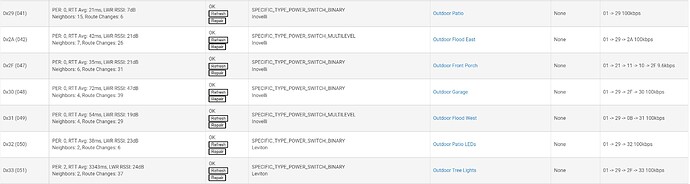

If you post screenshot of your Z-Wave details, there are a lot of people in the community that can take a look and let you know if they see possible issue.

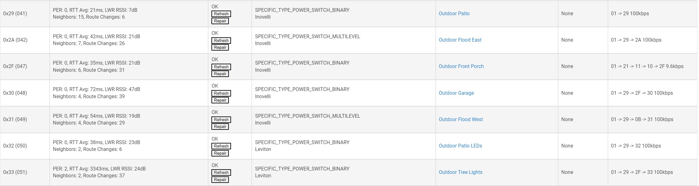

Here is a partial screenshot of the devices in my outdoor scene. the problems are the two Leviton plugs it seems. They are old and in a hot environment. Most of the time they do turn on. Some mornings they show that they are ON and they are not. They do not show in the log. I am going to replace these I think.
Changing them is likely a good approach, but the reason I was asking for your Z-Wave details is to see if you have any “Ghosts” in your network - ie devices that didn’t pair properly but that the Z-Wave radio is still trying to route through. This is an issue that can slow down the mesh and cause the types of issues you are seeing. I had this issue early on when I first setup my C7 hub. Had some great help to resolve it and it made a world of difference!
Learned a lot about Ghosts recently. I do not see any in the zwave details. Everyone has a route.
