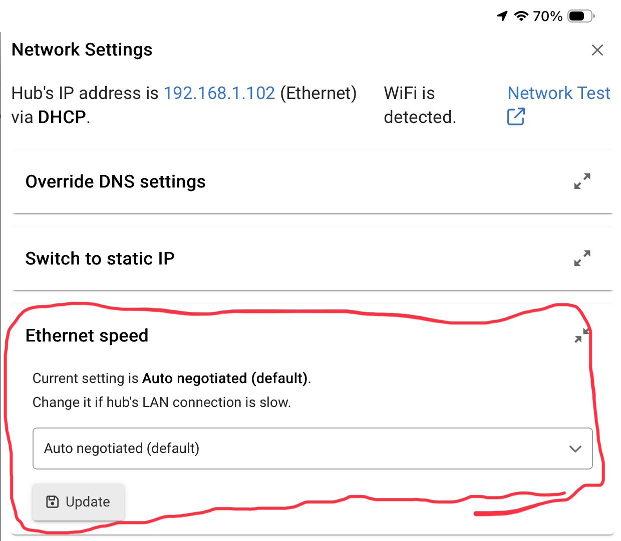

I know it sounds like voodoo science stuff, but if you see slow or incomplete downloads of updates, flip this from 100MBps to Auto negotiated OR the other way around. That is change what you currently have and click “Update”.
This is stated many times in this forum.
