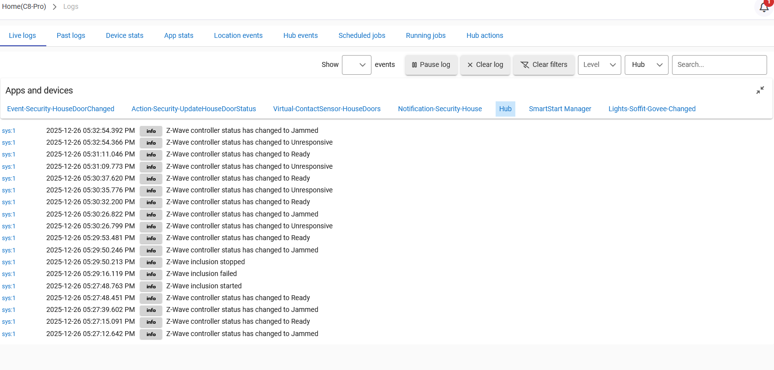

Still no luck...I've attached the logs for the Hub and SmartStart Manager:
Did you start inclusion manually? You are not supposed to do that for SmartStart, it goes by itself. Have you read any of the directions?
The Zwave radio constantly going to Jammed and back again I am sure is not helping.
Something bad is going on with your zwave devices.
No, i definitely didn't start inclusion manually. I have read all of the directions multiple times. All I do is use the newer elevation app to add the device...hit the plus button, choose "add smart start devices, then take a picture of the qr code. That gets it added to the smart start list. I then insert the batteries into the lock.
They must have changed the log messages then, because the last time I used SS the initial log message says something about SmartStart. Those logs you posted are exactly what shows when you manually start pairing.
Either way, you need to figure out why the radio keeps jamming.
Shutdown the hub and remove power for a few sec, see if that doesnโ€™t clear the zwave jam errors
