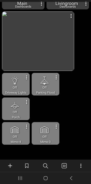

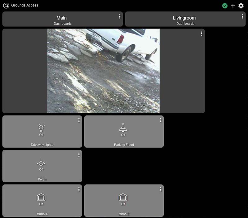

I found a cheap old MJPEG camera to point at my gate access and messed around with the "Image URL" and got the video to display... On Windows only... :roll_eyes:
On Android using multiple browsers the Image Tile comes up as a broken image. (Chrome, Brave, Samsung[bleh!]) This only needs to work on the local network. I have a VPN so I'm always "local".
My guess is maybe that Android doesn't correctly deal with the user name and password in the URL but I'm not sure if that is the issue.
  • If that is the issue: Any ideas on how to fix it?
  • If there isn't a solution does anyone have a cheap (CHEAP!) camera that will work? Only real requirements are: No "cloud" cameras (such as Ring or anything that requires Internet access) and I don't want any battery powered cameras. A wider angle view would be nice.
Android page :arrow_down:
Windows page :arrow_down:

Tried it and that does work in both Brave and Chrome which is pretty frustrating. Doesn't make sense that the URL works in the address bar but doesn't work in the page.

Nope. That isn't it. :confused:
Cloud links are disabled on all my dashboards plus you can see the local LAN's IP address in the address bar.
