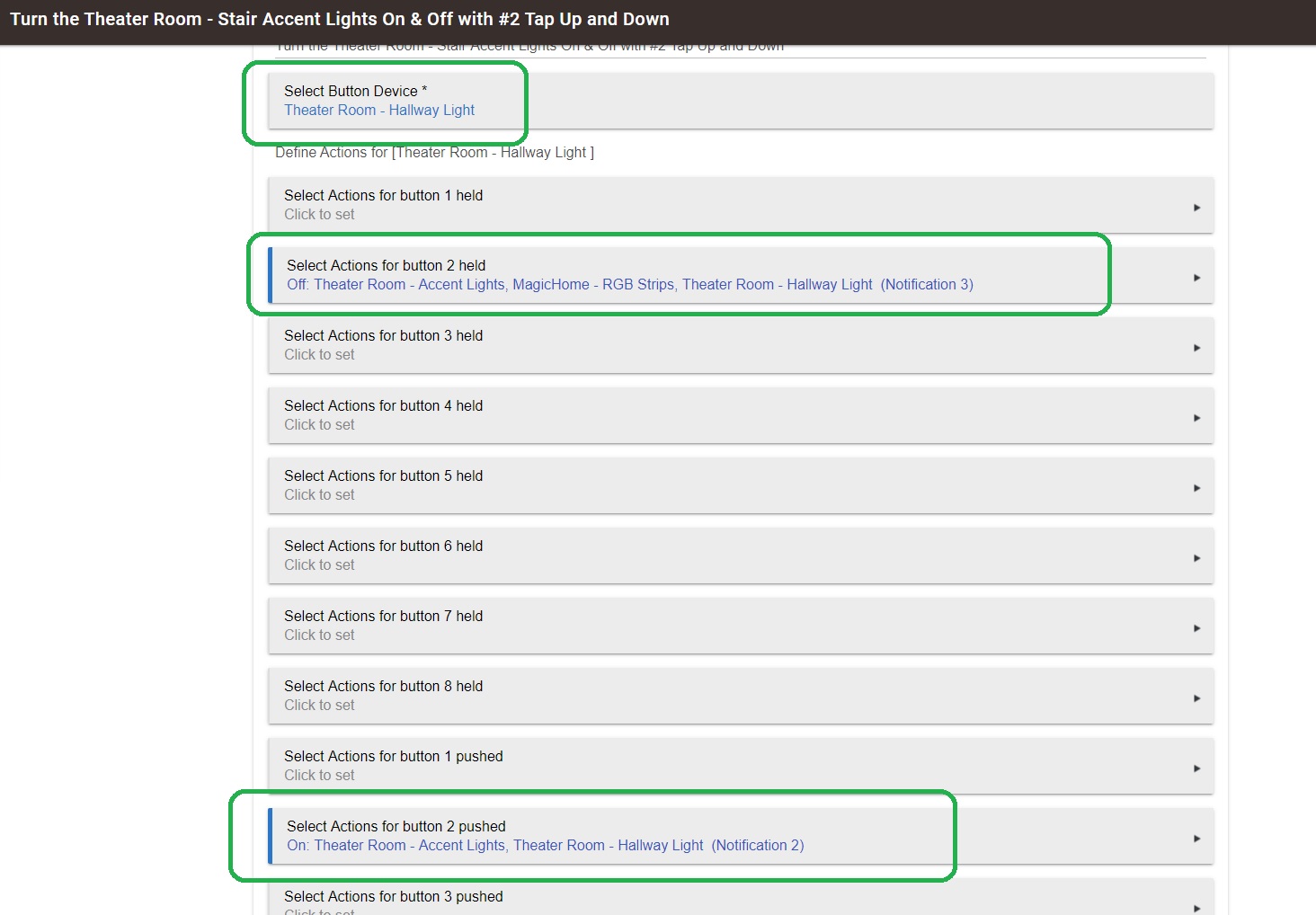

But I created a scene were if you 2X Tap the Upper dimmer switch, it would turn on our theater room RGB strips lights on, and run Notification #2, and that all work just fine.
But when you 2X tap the Down dimmer switch, it does turn off all the lights that it set to turn off, but it does not run the Notification #3 on the dimmer switch like it's suppose to?
Can you run the LED Notification scene when you Tap down on the Inovelle dimmers?

Just tried to create two separate rules, one for turning on the lights and another one for turning off the lights, but I still get the same issue,

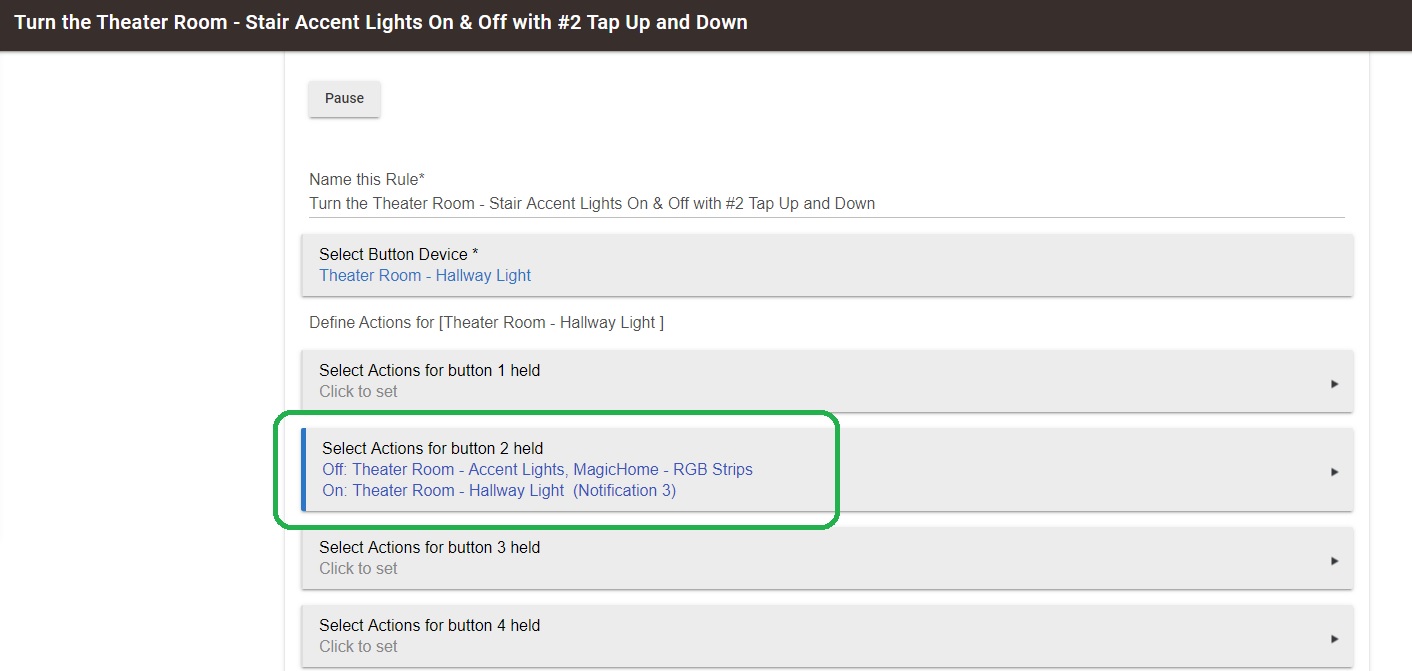

Wait a second... Your button controller rule us turning off Notification 3 instead of turning it on. That's why you're not getting the notification. If you want to turn the lights off and turn on the notification, that's what you have to have for button #2 held.
It should be "off Theater Room- Accent lights, ...... On Theater Room - Hallway Lights (notification 3)
@Ryan780
Yep, that was it... It's working fine now.
Thanks for spotting that!
