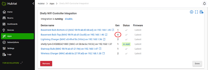

ISSUE - Shelly WiFi Controller Integration
Hub Version: C8 Pro
Current Software Build: Beta 2.4.4.120 (long standing issue since 2.4.3.?)
Connected to network via internal LAN
Bug?
Good day,
I installed this integration on or about v 2.4.3.171
I've noticed on more than 75% of reboots, some (or all) of my Gen1 devices fail to come back online. They will be listed in the integration as Gen "0"
I've tried without success:
(1) Disabling, then re-enabling the integration.
(2) Disabling, then re-enabling the affected child device(s).
What has seemed to work consistently is a reboot (with Rebuild database option)
There are no "log" entries created for this integration that I've found.
Are there any additional troubleshooting steps (or screen uploads I can provide to assist?)
