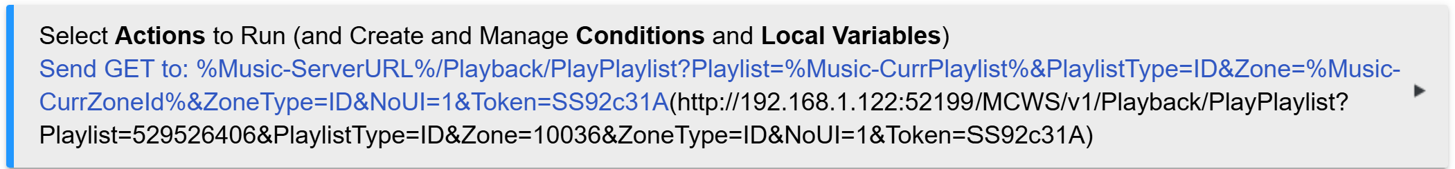

Rule Machine Rule: Http Request/Send Http Request
Background:
This rule had been running for years, it stopped working sometime in the last few months.

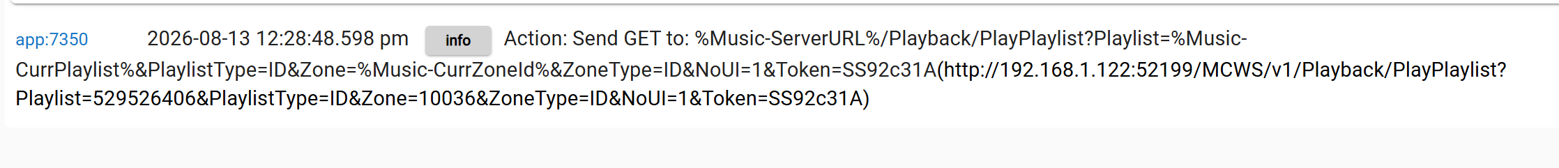

Logging: No error logs are produced.
Diagnosis:
If I copy the request directly from the rule: http://192.168.1.122:52199/MCWS/v1/Playback/PlayPlaylist?Playlist=529526406&PlaylistType=ID&Zone=10036&ZoneType=ID&NoUI=1&Token=SS92c31A
And if I "paste and go to" it into Chrome the request functions perfectly emphasizing that there is not a permissions error on the MCWS side.
