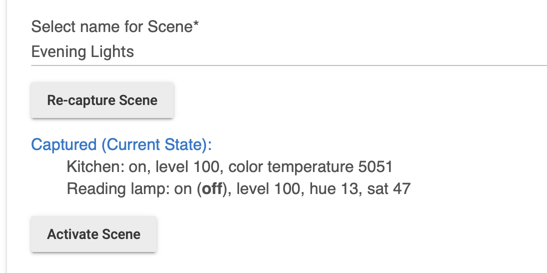

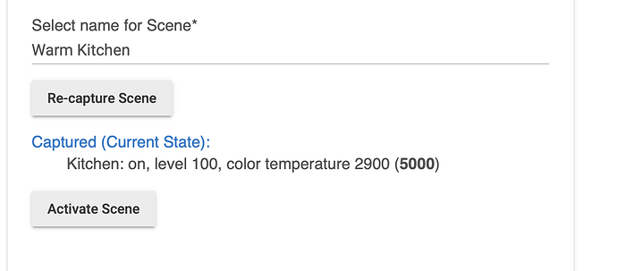

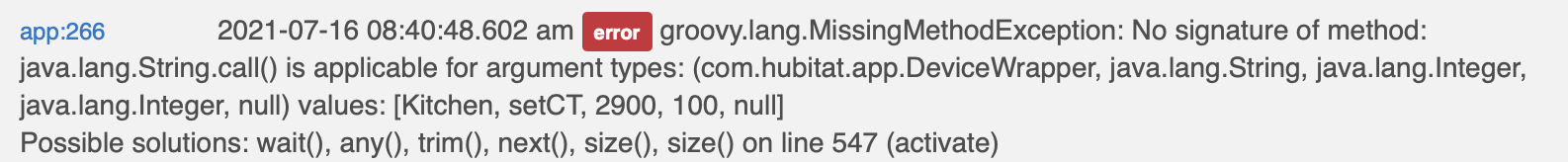

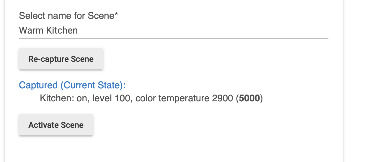

Same problem with scenes here. The scenes with my kitchen lights, which are Hue white bulbs via a Hue bridge, are the ones that error. When this scene is activated, the "reading lamp," which is an RGB bulb, changes correctly, but the kitchen does not.
Here's one of the scenes:
And here's the error:

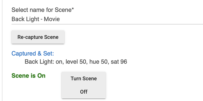

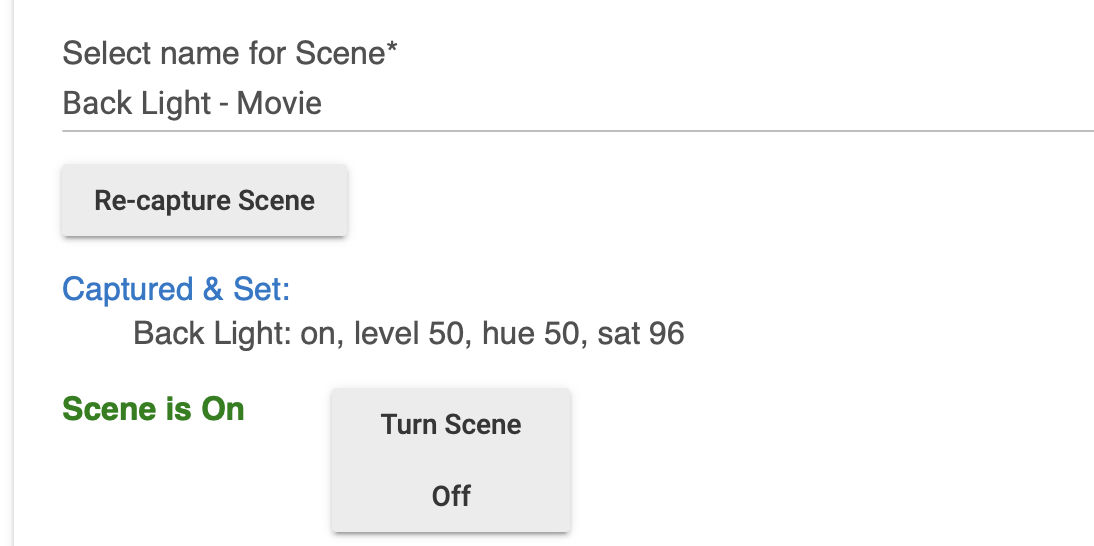

This scene, which sets the color of a strip light I use for a backlight on the TV, works just fine. Don't know if it's the difference in RGB vs white bulbs?

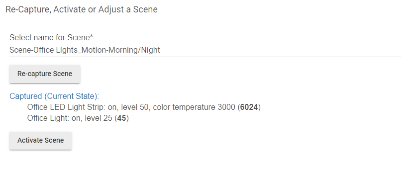

Still getting an error, but the color change does work.
Scene:
Error:

Well that's bizarre, because that line of code was changed. The error shows an attempt to call a method with 5 parameters, but there is no such call. That was the bug.
Evidently, something went wrong with this build wrt to this change. I can reproduce the error.
