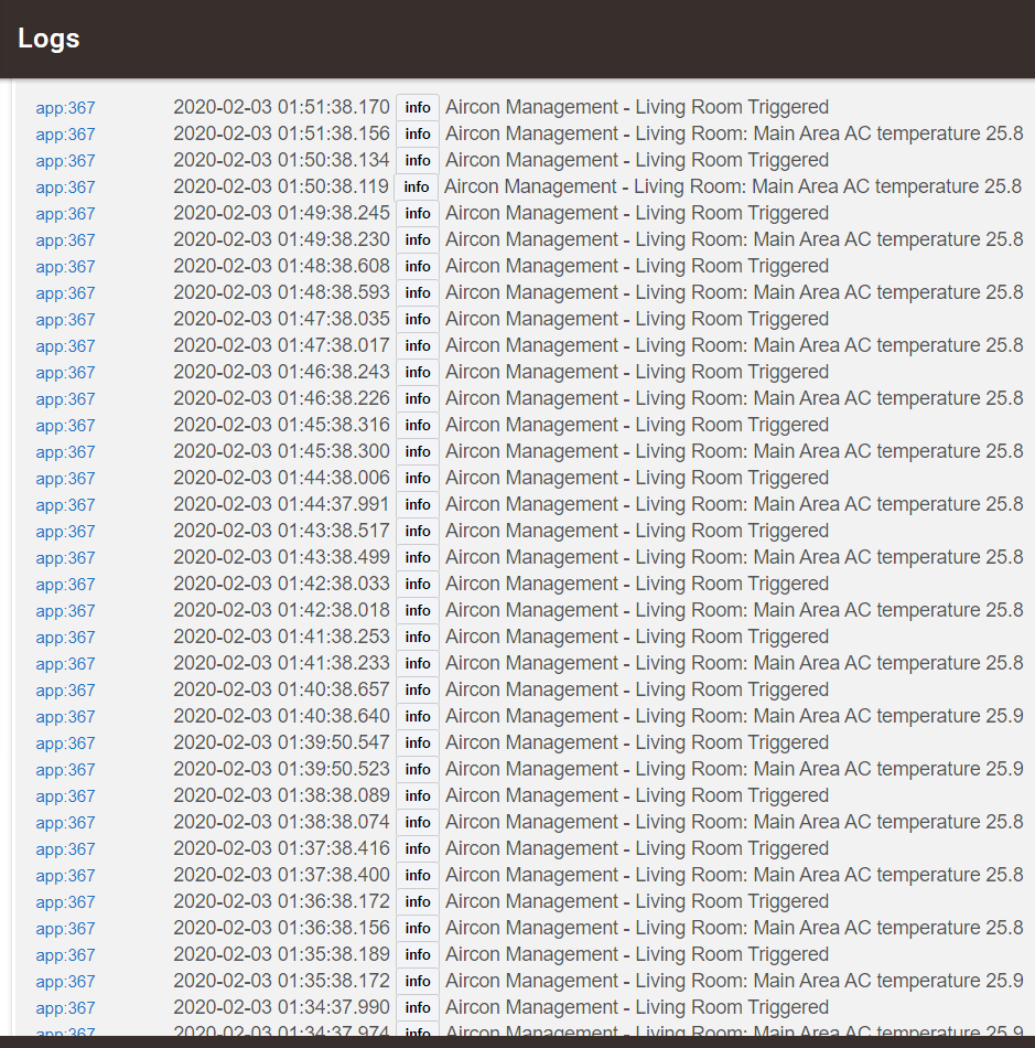

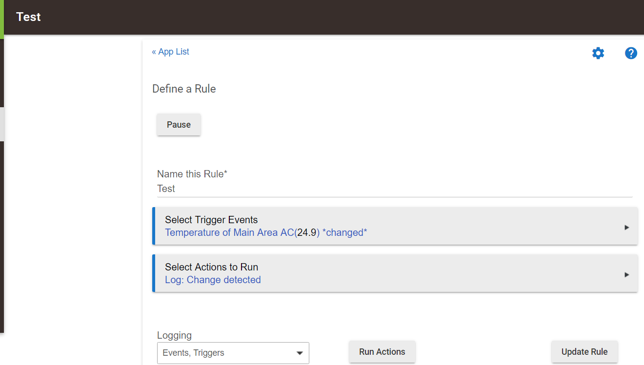

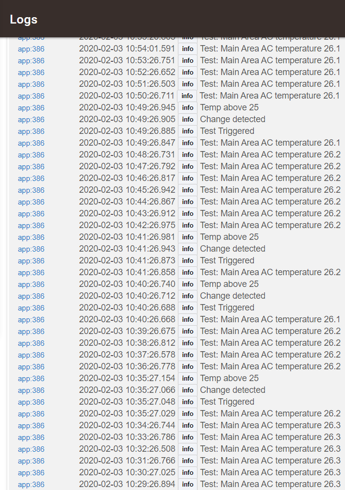

Issue: Inconsistent Triggering on *changed* event
I've recently been setting up some automations for my air conditioning system, and I noticed that my rule seemed to be triggering more than it should. I have it set to trigger when the temperature of a particular sensor is *changed*. I think it used to trigger properly, but then started triggering every time that sensor was updated, even if the temperature was the same as the last time. I decided to create a new, very simple RM app to see if it would trigger on every update, or only when the temperature was actually changed. Sure enough, the test rule only triggers when the value changes. Here are some screenshots of the two apps, and the logs created by both.

You're right, I do have other conditions in the Actions part of the code. You got me thinking that maybe you were onto something, so I just tried modifying my Test app to include some conditions, too. But, as I would expect, the conditions in the Actions still don't cause the Test app to trigger if the temperature has not changed.
But in the lower log picture (Test), it still say it triggers when the temp has not changed (first trigger from top, temp is the same before and after. So it seems to me that the trigger goes off, but the actions do not? Or do I miss something? The thing is, the actions only appears IF the trigger is TRUE, not the other way around. If the actions do not work, then you have set conditions in the action to maybe kill itselves. Fast and easy to do, so did you try to turn on the debug log on the rule? Turn on to the left of Done button(slider) to get more info what the rule actually does.
The whole rule might be helpfull here... :wink:
RogerThat
Which timestamp are you referring to? When I look at my screenshot of the log for the Test app, the top 9 entries (from 01:42:37 to 01:50:38) all show the same temp, and no triggering of the rule.

No, that's not really the problem that I'm seeing. The actions are properly running every time the rule is triggered, but the rule is being triggered more than it should.
In the Test app, the logs are showing every time my Sensibo integration polls for the temperature, which is set to 1 minute for this testing. But this is not necessarily triggering the rule, it's just being logged. Then, if the new temp is different, the Test app is triggering, which is each point where you see "Test Triggered" and "Change detected" in the logs, and then my simple conditional actions are also running ("Temp above 25"). So, the Test app is behaving exactly the way I would expect, and I'm sure this is the way triggers are intended to work.
But in my actual AC app, you can see that each time the temp is updated, the trigger is also firing, even though the temp is the same. The actions are then also run each time, but I didn't include the actions in the logging, because the logs would be too verbose.
