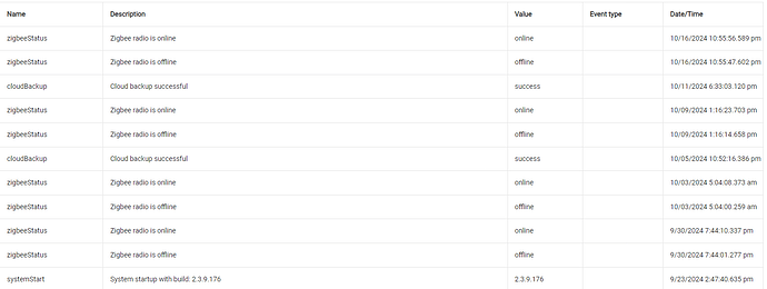

I seem to get a lot of these .. is this normal ?
Zigbee radio is offline
Zigbee radio is online

I have got this on all vers .. not just 176
176 is sofar is the best as everything works ok and has been the best for memory loss.
Uptime 17.81 days < on 176 = best i have ever got.

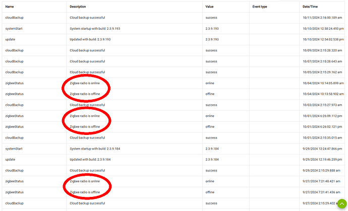

I have been seeing this on my Zigbee hub (only one of my four runs Zigbee) since at least this Spring. Sometimes it goes for as long as three weeks without logging one of these, I have not been able to correlate these events with any other event(s). When it happens the radio if off for 7 seconds.
I was under the impression that this was a known issue and was being worked. Also, it's very low impact as it only causes a problem if it happens just as a Zigbee automation is trying to fire. I have been waiting patiently for a fix.
Let me know if I can provide any additional information that would help.

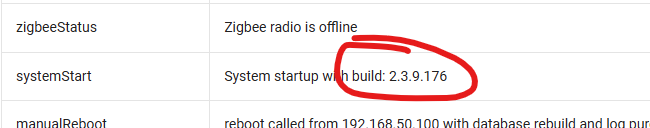

Still getting them here also .. System with build: 2.3.9.176
FWIW, your's is a different issue, @swiss6th is in a continuous Zigbee radio boot loop every 30s. Triage nurses will put him first in line. :wink:
