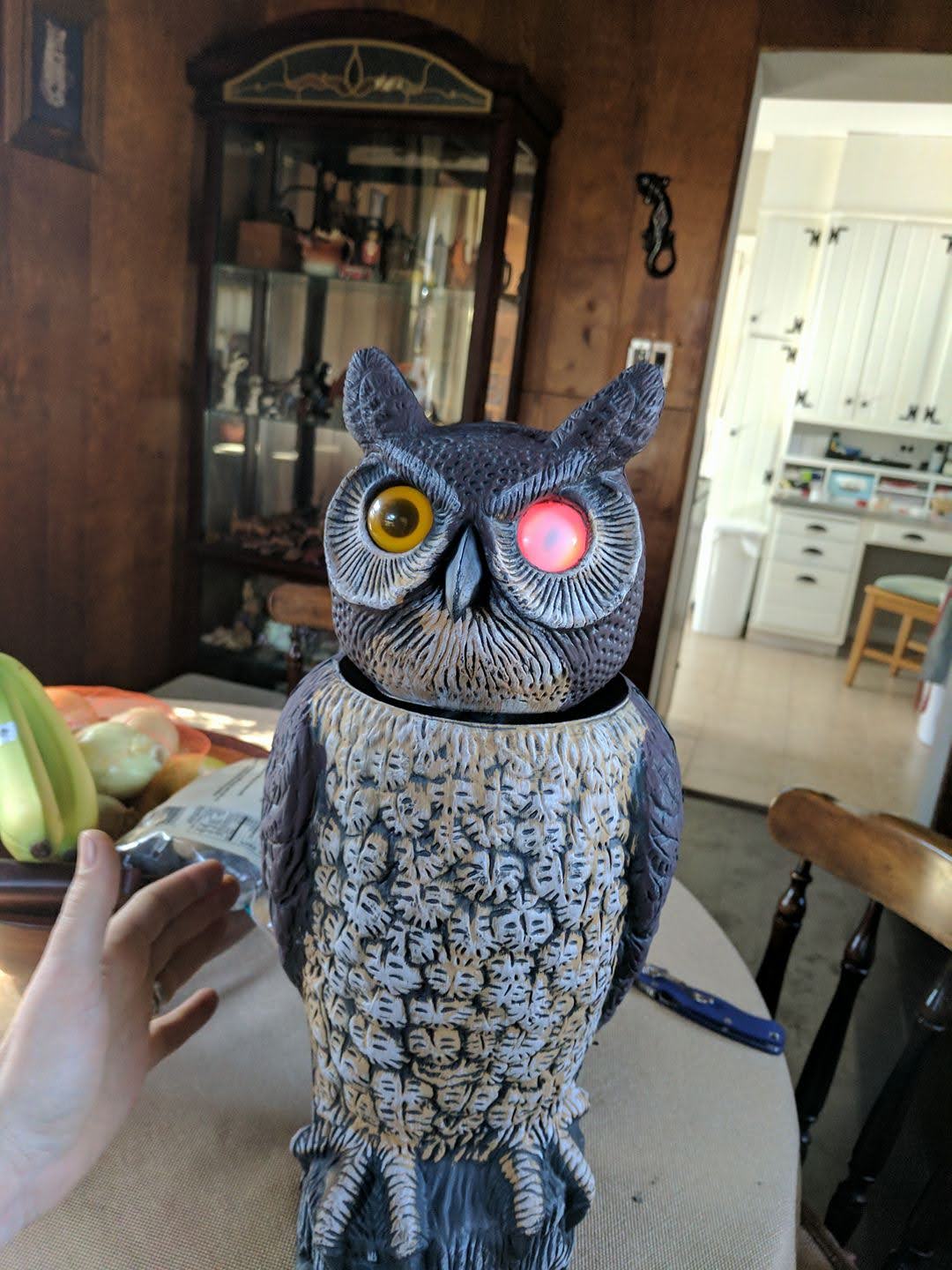

The "Fibarowl" is a Fibaro motion sensor installed in a hollowed out fake owl's eye socket. Kind of a fun project, and I used it to turn on some decorative lights and freak people out. BUT the sensor has begun falling apart and actually ran out of battery months ago, so I might retire the whole art project if it's bogging me down.

I Fibarowl!
Hahahah, now that's pretty cool.
I have that exact same owl to try and shoo birds from my pool area.
BUT... Since barn owls like that aren't native to South Texas, the birds could care less and even on the 1st day were completely unimpressed by it. In fact, on day 1 a sparrow landed on its head and camped out for a while.
