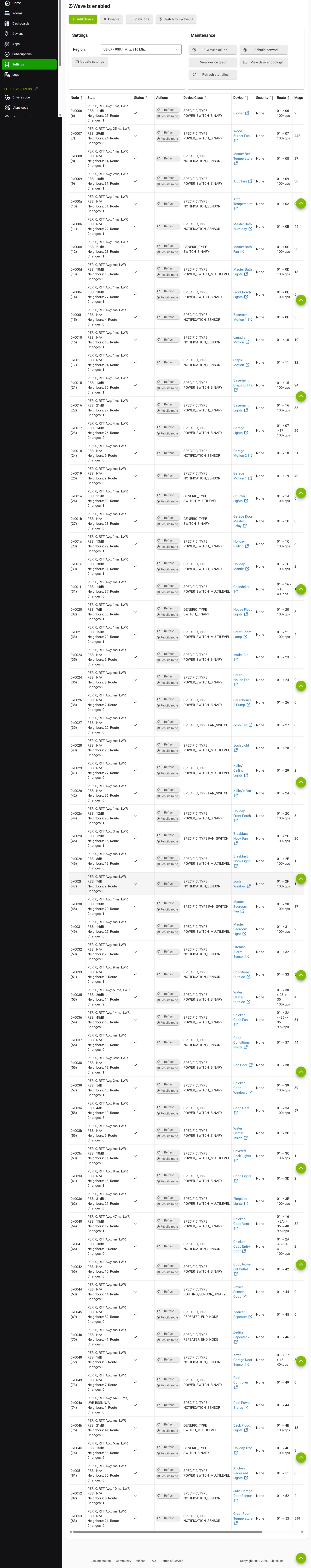

You have a screenshot of the device list? Not the logs, but the actual device list in the Zwave settings page?
Nothing obvious there. But... I did notice something that might be a clue. The line in the logs without a number seems to be routing through [0x38]. At least every now and then. dev: 2026-02-10 09:17:23.143 AM info seqNo: 130, routeChanged: true, transmissionTime: 7ms, repeaters: [0x38], speed: 40 kbs, rssi: [-89 dBm, N/A, N/A, N/A, N/A], Ack channel: 1, Transmit channel: 1
Not seeing anything obvious. The only thing I can think is if you added/replaced/removed a device recently.
