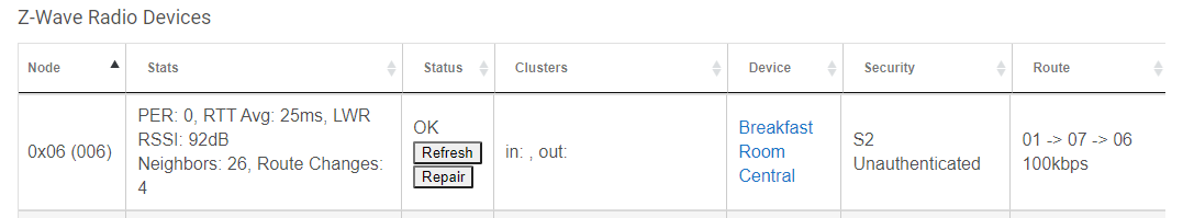

Question:
Is this a Ghost Node? (It doesn't have any in/out clusters).
It seems to be controllable from the device page:
Question:

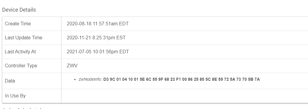

The status is OK, there is a device assigned, it has S2 security, and I see a route, LWR RSSI, neighbors, etc.. It's not a ghost.. Is this device functional?
It looks like device data was removed.. This is where the "clusters" comes from ..
Hi. Thanks for responding.
I excluded it, and re-included it. No Issues.
(Of course, I had "real" ghost devices created, but I got rid of them with PC Controller.)
