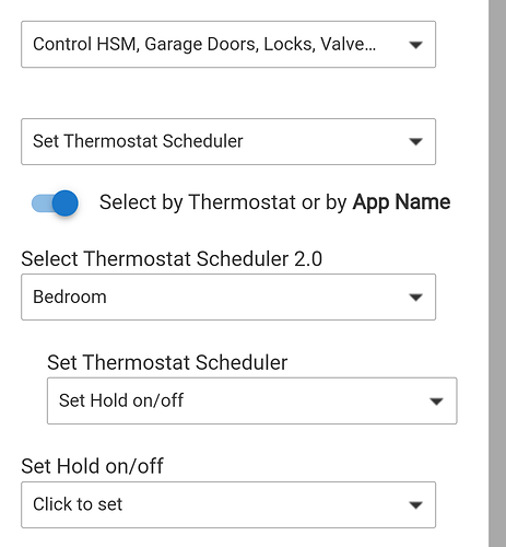

There is a hold on/off command for thermostat scheduler in Rule Machine.

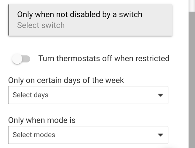

I use hold for my Workday heating schedule but you can also disable the scheduler with a virtual switch, which I use for Summer/Winter seasons.
Cool (forgive the pun). Do I want the hold on or off? Thanks so much.
Hold 'on' is paused

I have several schedulers, some set with modes and some set with times. My workday schedules are disabled if my day off virtual switch is on and I use hold to pause the mode set schedules so they don't interfere on a workday.

In your case, the virtual switch to disable the scheduler sounds to me like your best option. Thanks for the explanation of your situation.
You can get a physical device that would trigger the rule. One of the Zigbee buttons would work. Set the button to toggle the virtual switch on or off. Then set the rule to suspend or resume your schedule. This one has a low price:
