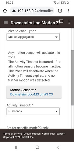

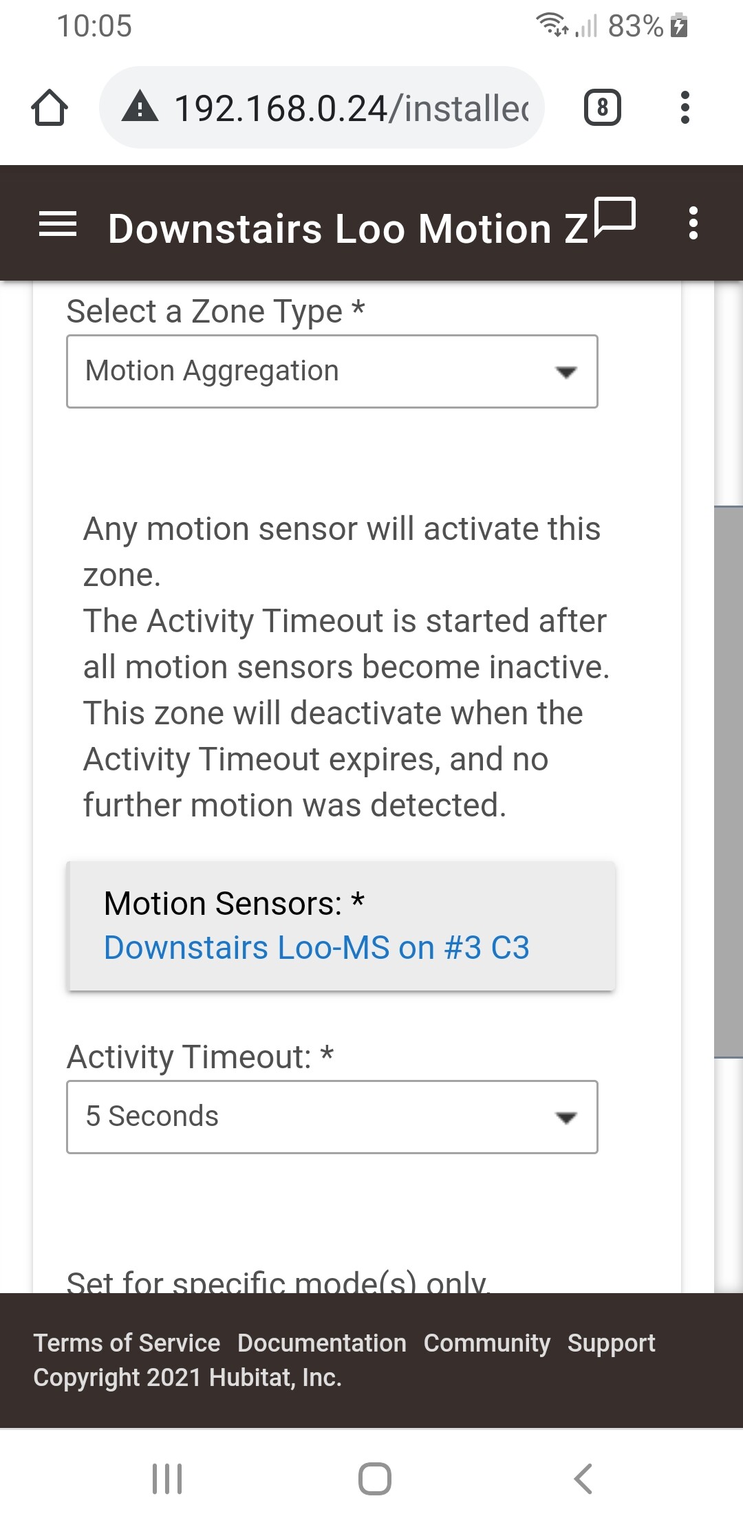

I put all my motion sensors into a zone using zone manager.
This way you only have to change the device in zone manager as my rules use the zone manager device.
I do the same with contact sensors using device manager.
This my way round the issue.

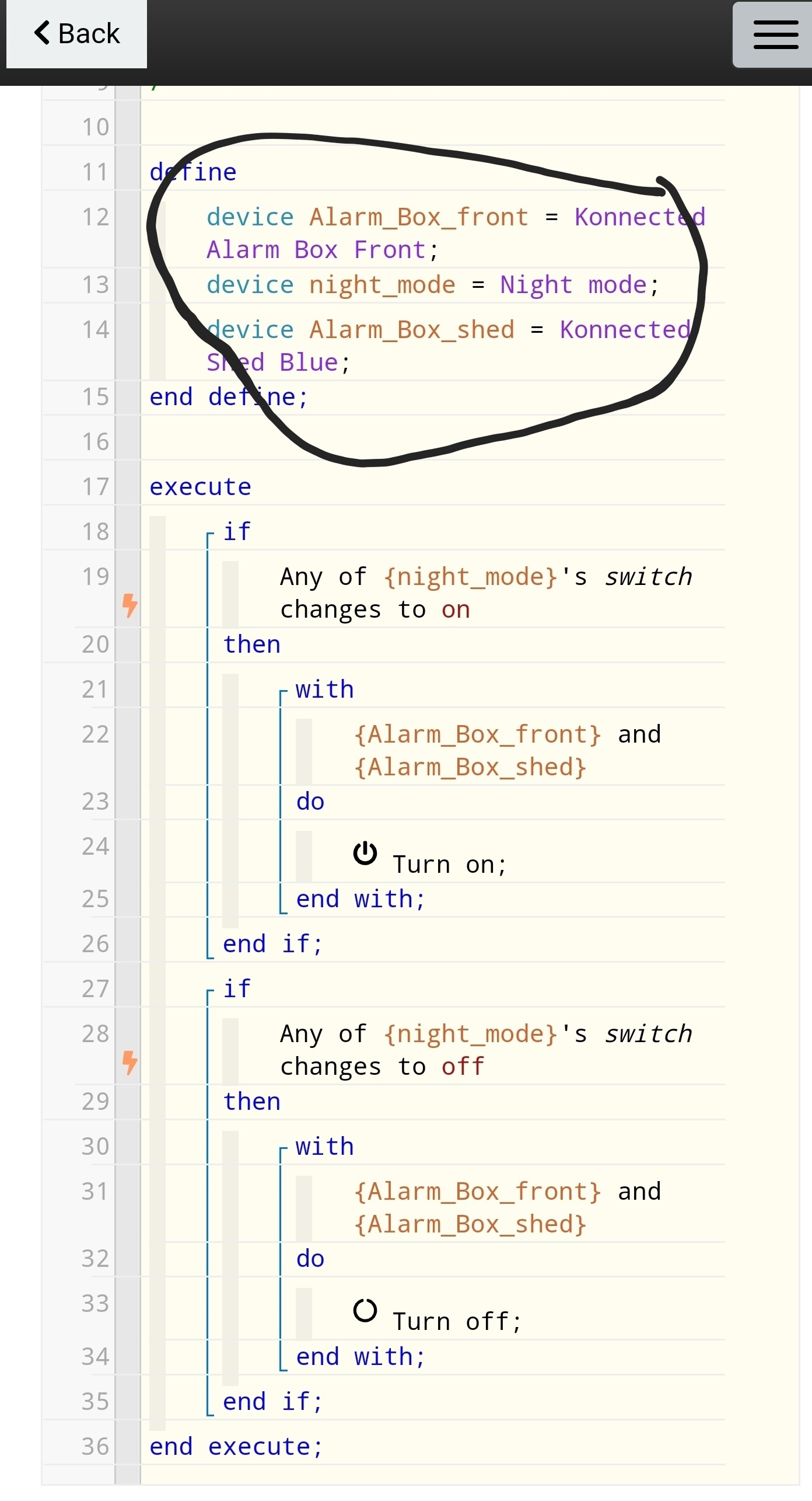

I guess with webcore you could set each device to a global variable and then use the global variable in the pistons. You'd then only need to modify the global variable if a device changed.
I don't know if having a lot of global variables would impact on performance or not, anyone?

That's exactly what I do, quite a bit to be honest. Can't comment on performance other than saying I have no issues.
