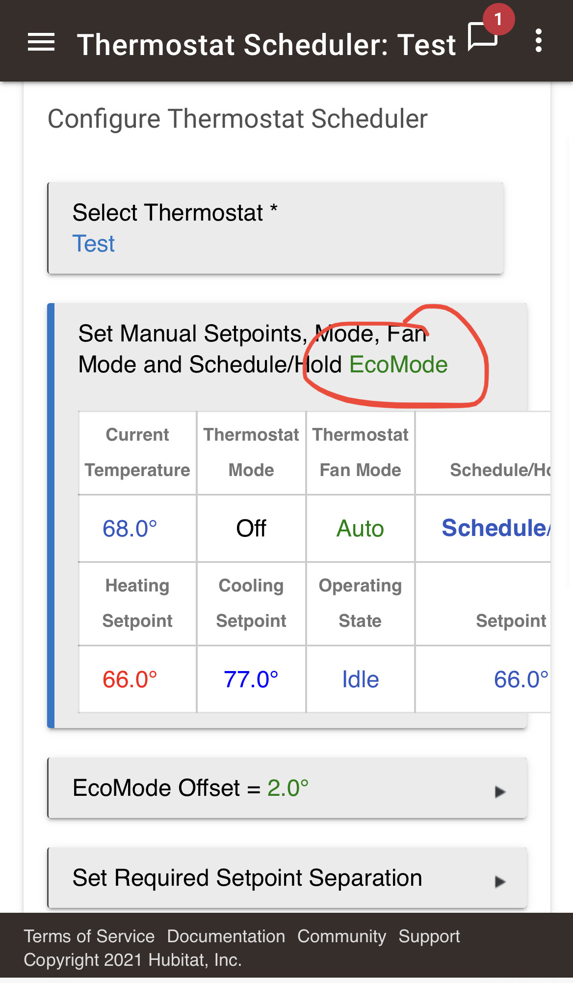

If I wanted to know if thermostat scheduler was in eco mode, I would browse to the app’s settings page and check there. Like this:

The Honeywell thermostat is one that uses the Total Comfort API C driver. I'm trying to figure out if you can tell if EcoMode was on in Rule Machine so I could do an IF EcoMode = True kind of test. I have worked around it at this point but would still be curious if it was something we could test for in Rule Machine.
So in this case, the thermostat device itself is irrelevant.
The question is whether rule machine can use Thermostat scheduler’s eco mode as a condition?
@bravenel?
No, there is no way to do this. But, the circumstances that led to eco mode are repeatable, and those could be used in RM.
