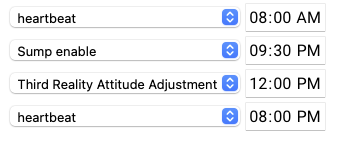

Do you mean something like this?
Where the left column contains a dropdown with all of the RM rules and the right column is a time to run that rule.
Yes!
Ideally, the times could be "sunrise" or "sunset" +/- an offset.
One other nice option would be the ability to run the set of all rules some amount of time (e.g., 5 minutes) after a system restart, regardless of the specified time (but with some buffer time, such as 30 seconds, between running each rule). A variation of this would be a checkbox next to each time to run only check-marked rules after a system restart (again, with a buffer time between the selected rules).

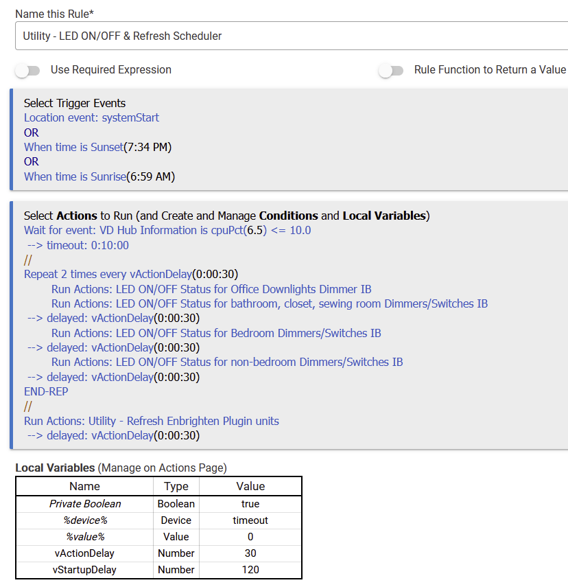

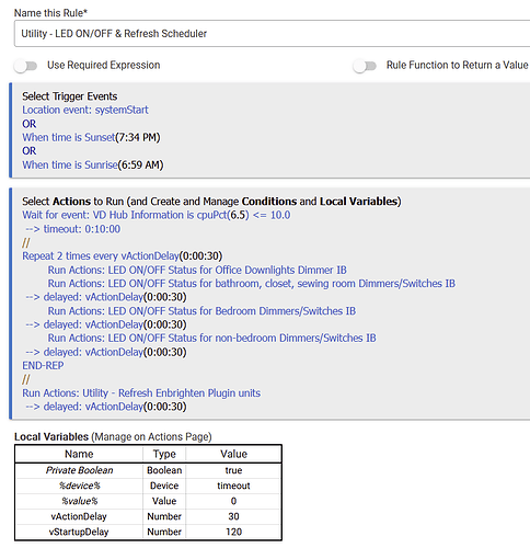

That approach looks so much nicer than my current "rule-running rule":
I've got to ask. It looks like you want certain things to run on a periodic schedule. Why not simply use a trigger of Periodic Schedule?
Most of the rules are for setting the ON and OFF colors/intensities for Inovelli Blue dimmer/switch units, one set of colors/intensities for the day time (hence the sunrise trigger) and one set of colors/intensities for the night time (hence the sunset trigger). I don't need those rules to run more frequently, and sunrise and sunset are the appropriate times for those rules to run.
The systemStart trigger is just to make sure that the rules run if sunrise or sunset is missed because of a reboot (which happens every few days as new beta versions drop).
