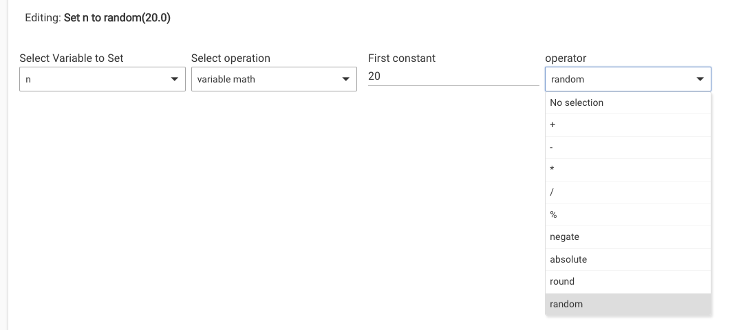

Both random numbers and random delays are possible. The former needs a Number variable, and setting it to a random value using variable math:
That sets 'n' to a random number up to 20.

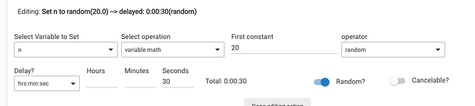

Random delay is available for every action:

The first constant is just an initial value?
It's the number used to calculate the random value. Random returns a number between 0 and 1, and multiplies it by that number to get the result. So it's an upper bound on the random number, while 0 is the lower bound.
