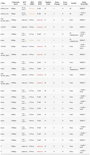

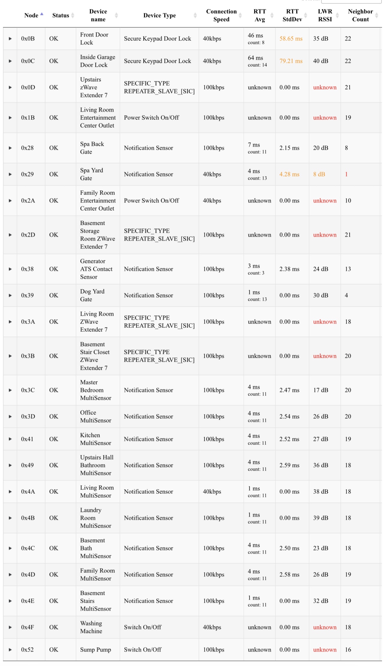

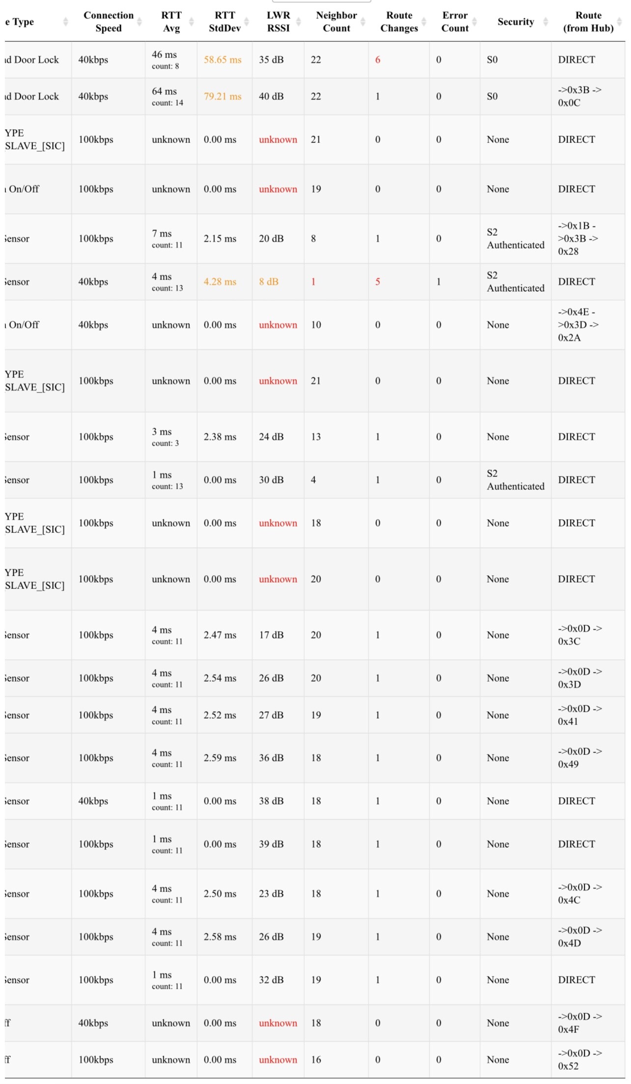

That said, the pattern of the log messages looks kinda like what happens when a unit drops into discovery mode, sending a bunch of repeat requests because it isn't getting an ack. Are you seeing lots of route changes by chance?

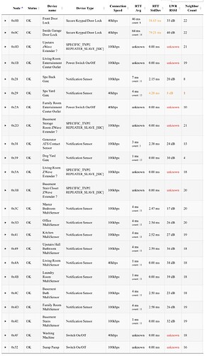

Looks better but how long since reboot? Need to be running 12-24 hours to get a good picture since the stats reset with a reboot.
Wow!

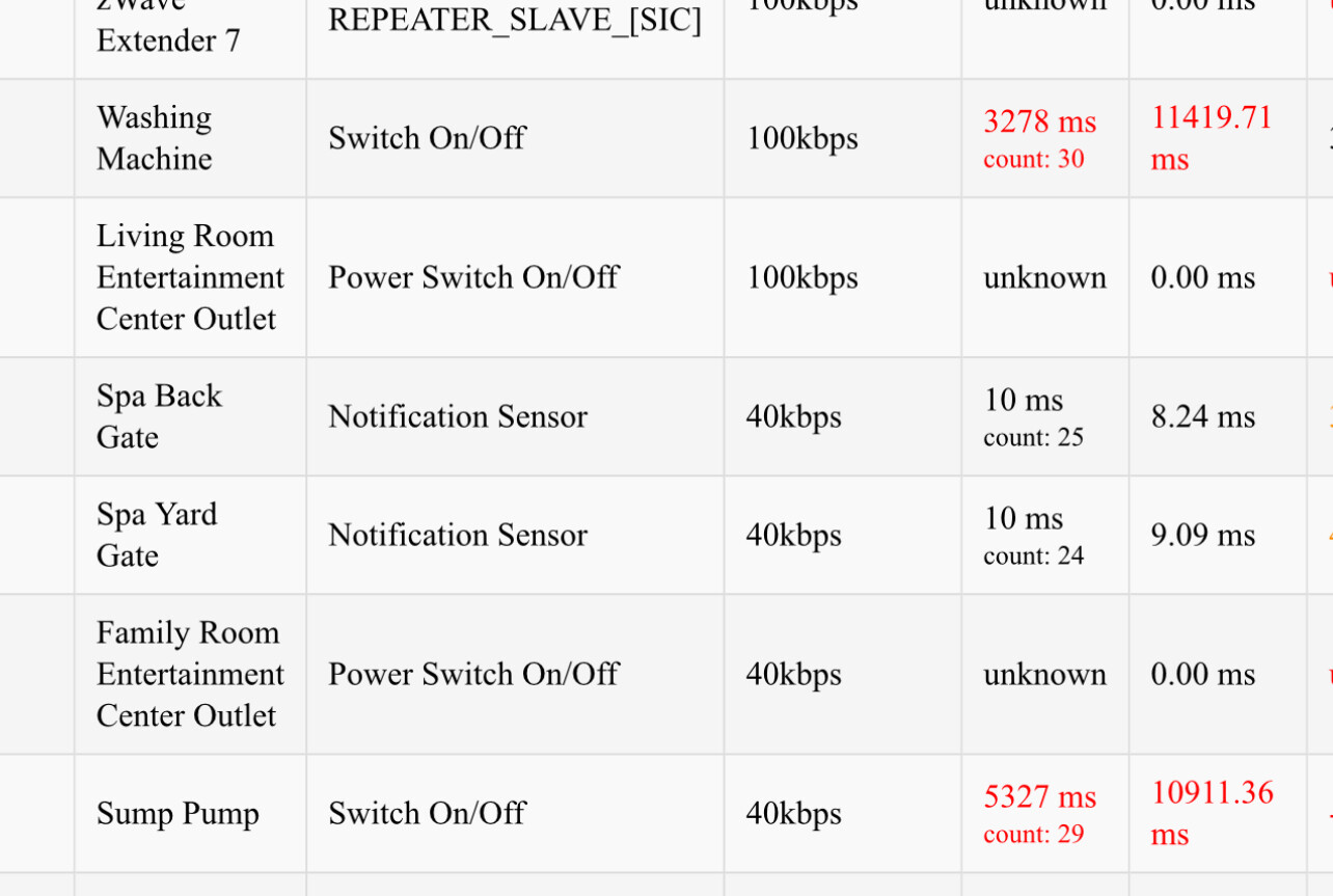

Someone (a lot smarter than me), once told me to look at the RTT Avg column.
Anything greater than 50 (or so), is pointing to a major issue.
The first time you posted, there were 13/19 devices in that predicament.
The last one you posted, there were 0/19 devices in that predicament.
That's a big change....
