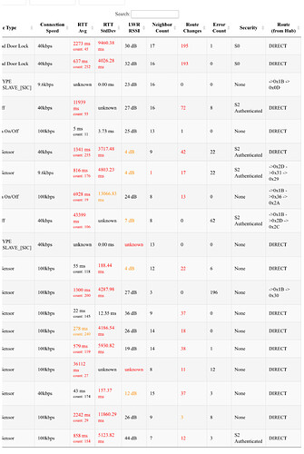

I’ve posted a few times seeking support for my ongoing ZWave issues. I got zero response here. My c7 is out of warranty, but was hoping @bobbyD would be able to look at my hub to see if my ZWave is bad.
I’ve been running the same hub with external radios for the last year and a half without any issues. I did find 3 ghosts from Iris plugs that I’ve removed and cleaned up. But I’m still having a lot of problems.

Looks like you have a lot of sensors and very little for mains powered repeaters.
Depending on the settings of the sensors they might be flooding the already weak mesh.

I found an Aeotec ZWave 7 repeater on my network that was inactive. I’ve unplugged it and plugged it back in. I also have two other repeaters that just arrived this past weekend that I have to get added to the network. But my house isn’t that big and previously I would say the majority of my devices are connected directly to my hub and don’t repeat.

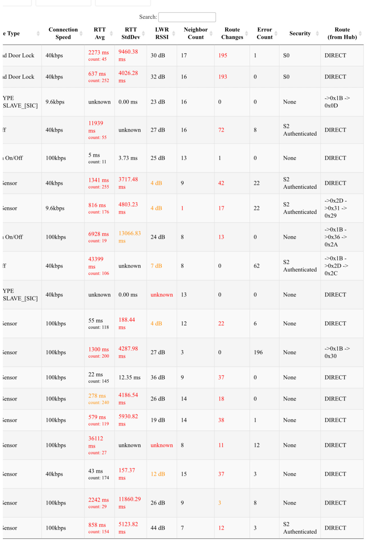

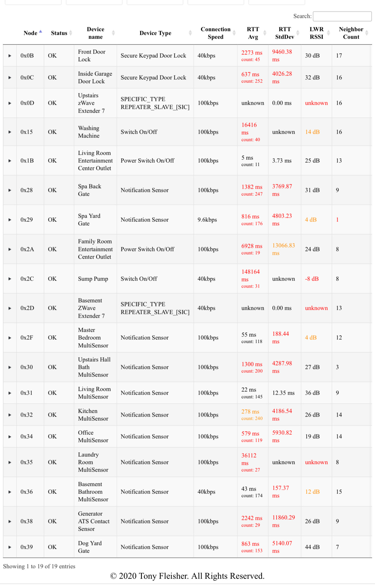

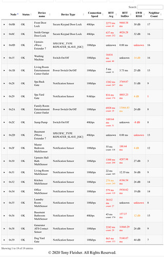

Here’s another copy of the ZWave details with the info on the right of the table.
My locks are 5 feet from my hub or less as an example.

Are you sending frequent commands to the locks? They seem to be very active, usually locks are mostly idle.
EDIT: power off the Spa Yard Gate and Bathroom Upstairs Multisensor.
Then do a shut down and power cycle the hub (unplug for 30 seconds).
Check back in a couple hours and see what the stats look like.
Looks like those two might be causing some trouble.

Ok if its been up for "weeks" then some of the stats are not as bad looking, but the RTT values are horrible, which is what is presenting as the issue to you. I assume slow or unresponsive devices.

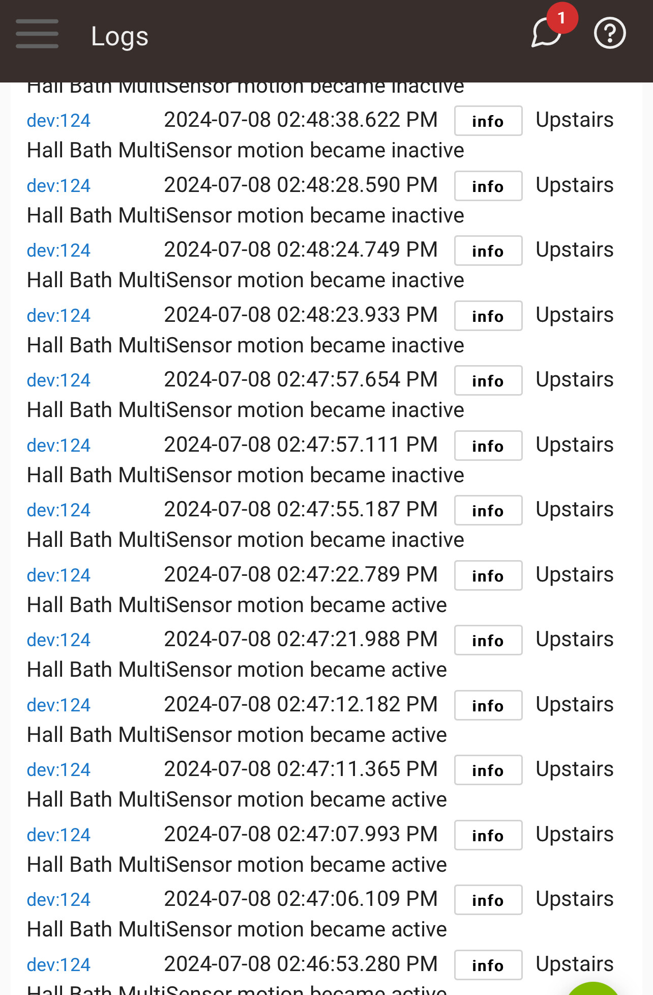

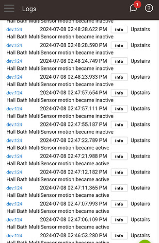

Yes that’s correct. The bathroom MultiSensor you mentioned is problematic and WAF has been bad since she uses that to shower and the lights keep going off I. Her mid shower as that detectable motion whenever anyone is in the shower.
Yes agree on the RTT, which is what made me wonder if my hub was going bad. I’ve never seen so much red on this chart in the past before.

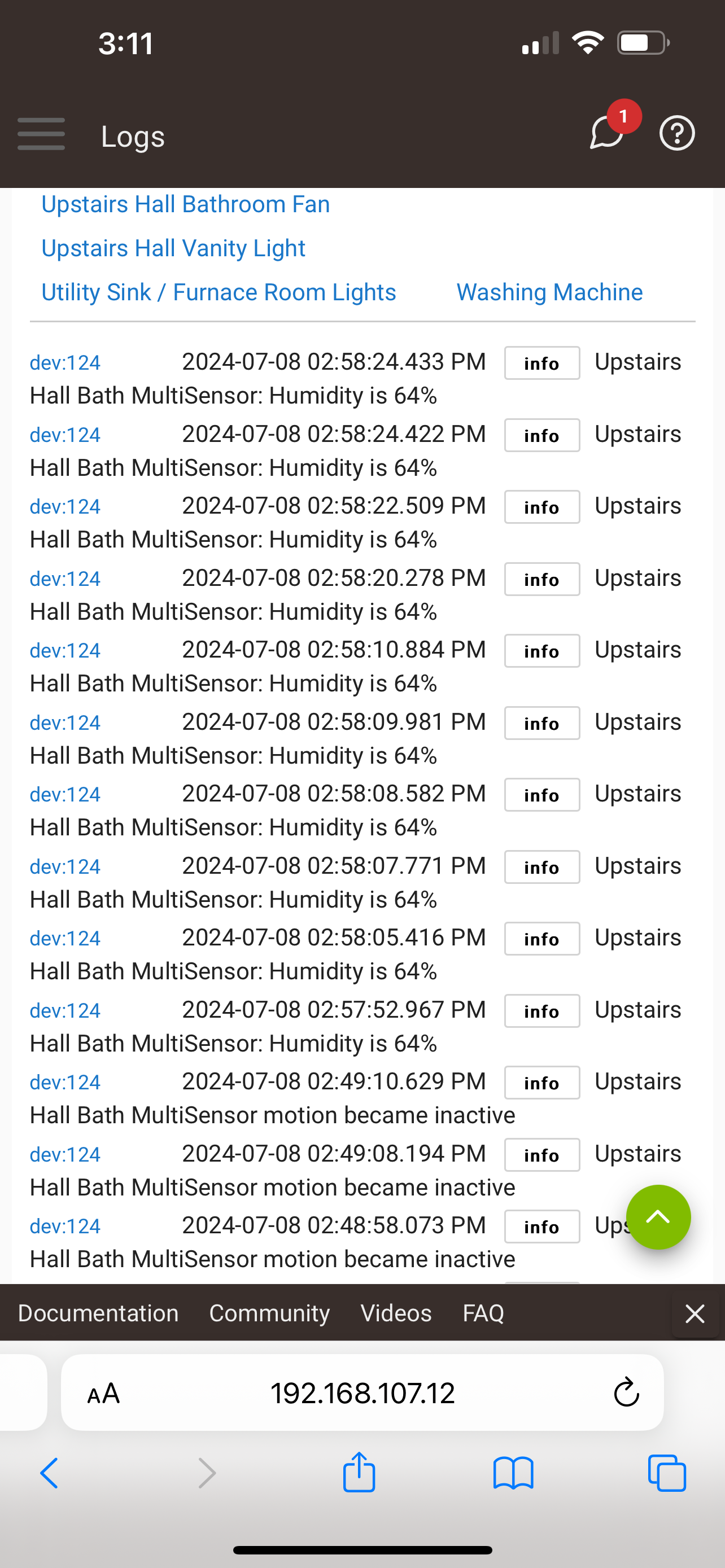

@bobbyD I noticed today my humidity isn’t updating / refreshing like it used too on my MultiSensor 7 devices. I isolate my ZWave to its own hub and used diagnostic tools to roll back to 2.3.8.140. But now I realized that 2.3.8.140 was pulled due to other issues. The only options I had for roll back are 158, 154, and 140. Anyway I can get on 141 from 140?
My MultiSensor are also spamming my hub repeatedly for the same query.
Using the stock MultiSensor 7 driver.

One rogue device can be clogging the radio, causing everything else to slow down. That was my strategy of taking those two devices offline, to see if one of them is the issue.

I would have an override for shower time. Usually people are hidden from view of a motion sensor when in the shower. If the bath fan is on a smart switch you can use that as a trigger to pause the automatic turn off for X minutes (that's how I do it for 30 minutes to be safe). You could also use a trigger from a smart switch if the lights switch supports multi-tap events.
Just for clarification, all my Aeotec MultiSensor 7 are on POE mains power. I don’t use batteries because I want the fast reporting. I’ve considered rolling back their firmware which I may still do.
Well if they are spamming, you need to fix it or turn them off, batteries or otherwise.
