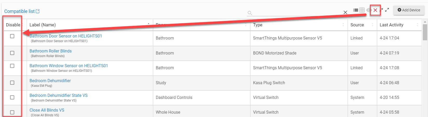

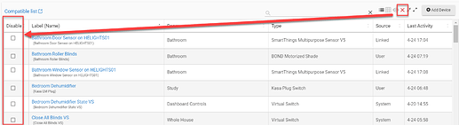

@BorrisTheCat - I think what @velvetfoot is referring to is the equivalent of the checkbox in the Devices page, where you can disable a device? Is that right @velvetfoot ?
Awww good point the RM through me.
@velvetfoot no there is no way to remotely 'disable' anything. If it's disabled how would you remotely re enable it? ![]()
The disabled app and device options are for debugging etc so they fully disable the app or device.

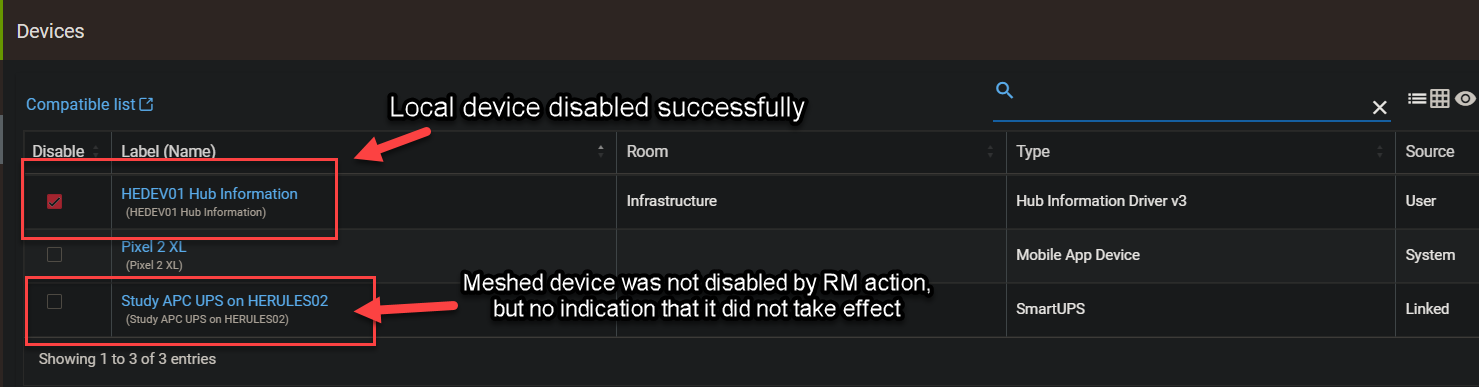

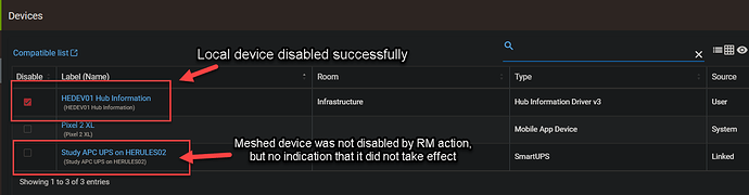

That's new? What does it do? Would be surprised if it fully disabled the device for the device page due to message above.
Looks like it worked for a local device on the hub where the rule is running, but did not work for a meshed device from another hub. Would have been nice if there was a warning in the logs for the meshed device not being disabled.

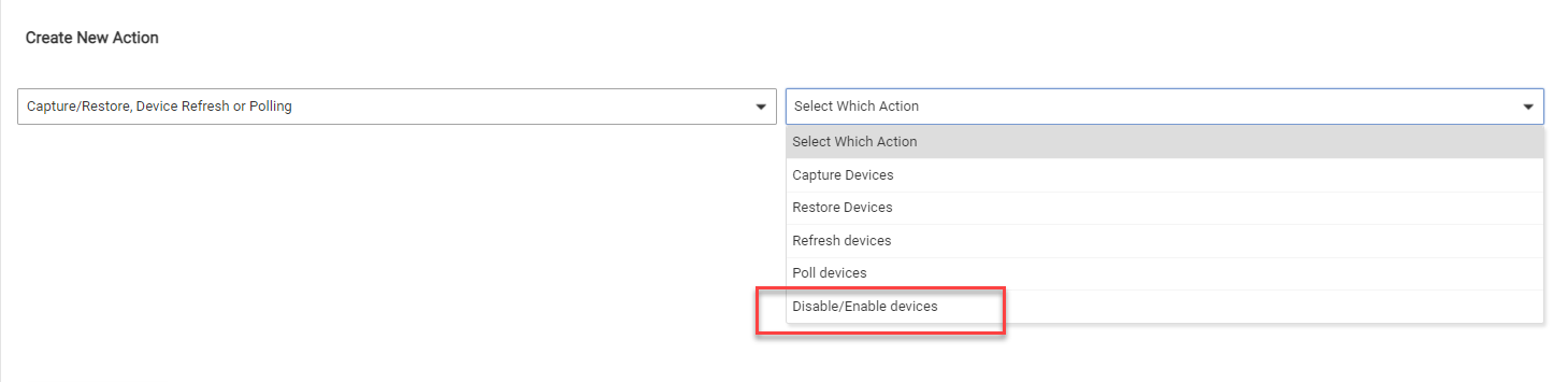

This is the correct action to use in RM as I am using it currently.
This action basically clicks the
for the selected device. This has been in the platform for many releases, there is an API for it too. I use it with a wake up rule for my son because he will quickly uses his bedside Pico remote to turn off the lights after they turn on. The rule now disables the remote and then turns on the lights so he has to physically get up to turn them off. 15 minutes later I re-enable the remote device with the rule.
