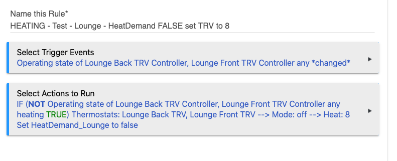

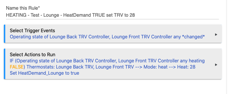

Is it possible to Combine these two rules?
I am pretty sure it is possible but not figured out how to have two different Actions assigned to different conditions yet.
Ideally - I would like a single rule to do the same for ALL 9 Thermostat Controllers/TRVs
ie if ANY of the Thermostat Controllers STATE change THEN
  1. If Thermostat Controller #1 STATE= Heat THEN set TRV SetPoint to 28c etc
    OR
    If Thermostat Controller #1 STATE!= Heat THEN set TRV 1 to SetPoint to 8c etc
  2. If Thermostat Controller #x STATE= Heat THEN set TRV x to SetPoint to 28c etc
    OR
    If Thermostat Controller #1 STATE!= Heat THEN set TRV x to SetPoint to 8c
etc
It looks like this could work - just figuring it out

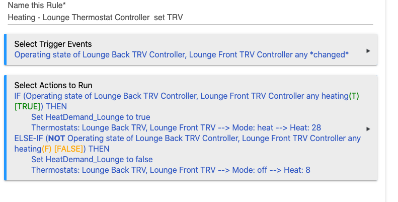

I think I have the case taken where I have one room taken care of
since it's a true or false for the same statement, you could just use ELSE instead of ELSE-IF
Good point !!!!
Thanks for reviewing - much appreciated.
That would be better but I think the Else If works ok so don't think it is necessary to change, I have loads of these one for each room :slight_smile:
definitely, if it ain't broke don't fix it. just keep it in mind for future rules so you won't have to go through all the clicking to make the condition again, lol
