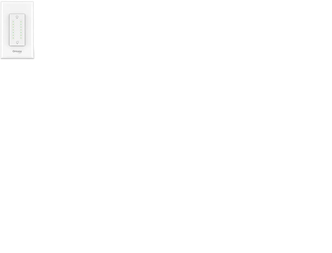

I really like this GHome light switch dimmer, but it is WiFi only.
Does anyone know if this can be used directly from Hubitat (I assume Hubitat will have to use http endpoints) without using the cloud or Google home?
