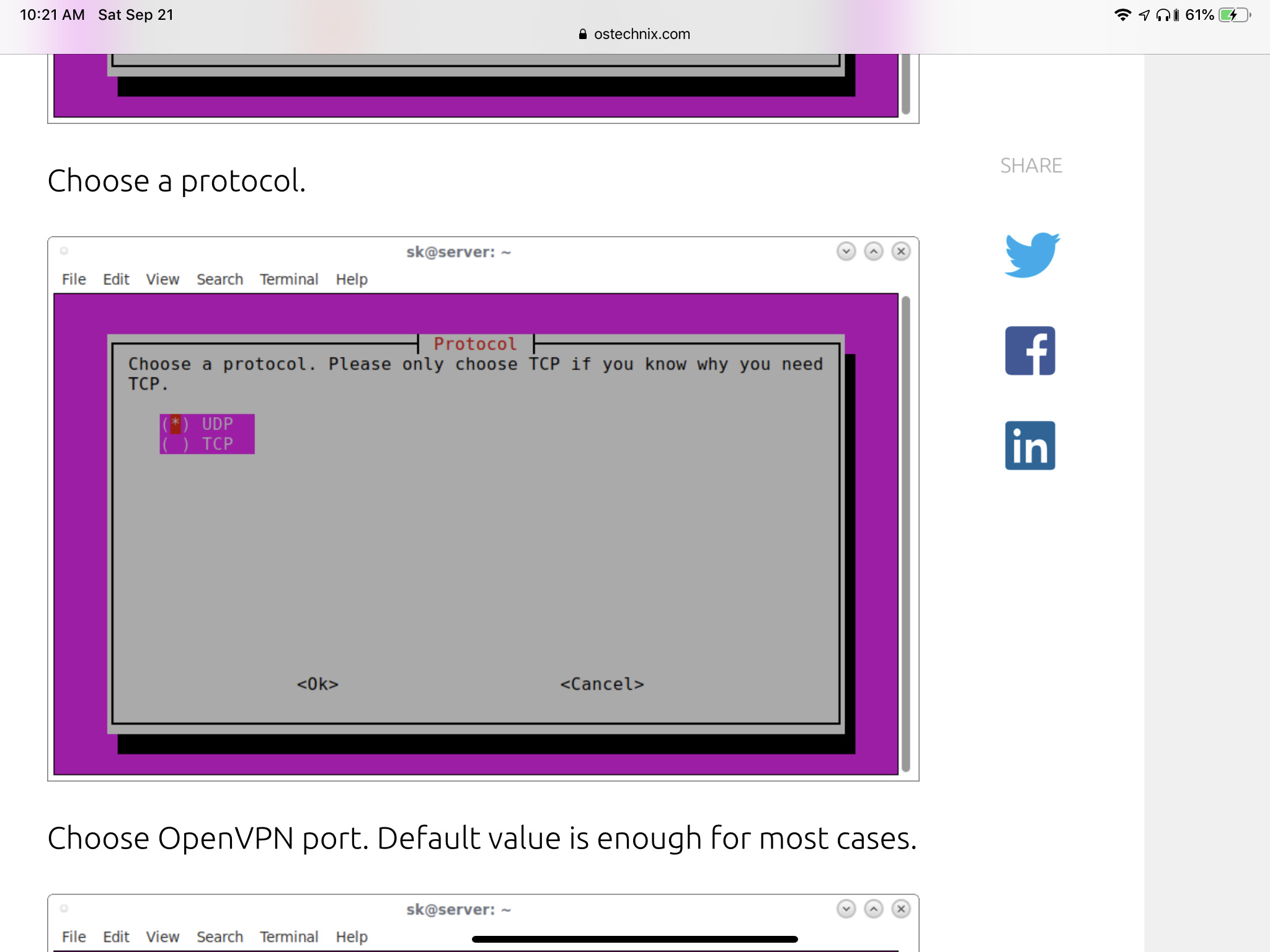

Silly question, but did you forward UDP packets to port 1194 on your Rpi?

Thx, I did not. What should I put as source and destination ports? I used port 1195 in pivpn.
Thank you
Both should be the same..1195

I'm glad you got your PiVPN working. @stephack wrote more clearly what I meant when I asked if the correct transport was selected in your port forwarding rule.
OpenVPN can use either TCP or UDP as the transport. UDP is chosen by default (I think), but TCP works more reliably in some situations.
