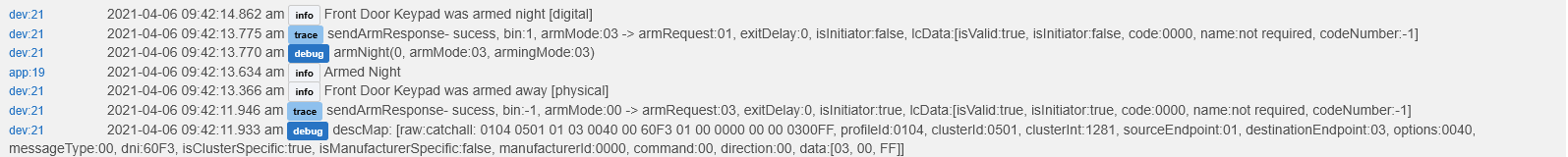

Hello all. New to Hubitat. Just received an ebay Iris v3 keypad. Having an annoying issue.
Pressing the Partial Button seems to work as expected, placing the system into Night mode.
Unfortunately, pressing the ON button also puts the system into Night mode, both "digitally" and on the keypad, as I see the partial button light up.
In trying to test the issue, I simplified the system, removing Night mode and just leaving Away mode in place. Pressing ON then acts as if it is arming in away mode on they keypad, however there is no change in the state on the HSM app, and no alarm triggering behavior.
Arming the system to Away in the HSM app does seem to work, and the keypad on button lights and beeps.
Here is a log from pressing the ON button on the keypad:
I have removed the HSM app and removed the keypad and reinstalled it, with the same behavior. Any ideas?
