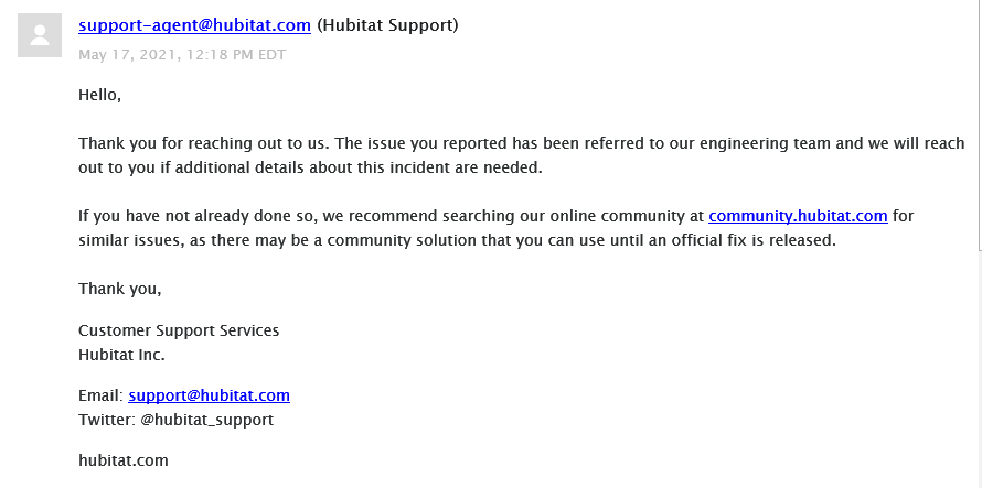

I am a new user. I have six Iris V1 motion sensors controlled by the Hubitat. They gave me false alarms every night. Every time, it came from a different one. Is there a way to reduce the sensitivity of the motion sensor?
Hubitat official support is not available. I sent an email to their support team. This is the last email from them. No solution.
Well, they are available, they replied to your email :slightly_smiling_face:.
As the boilerplate response says, the issue you reported is apparently one that’s been identified previously and has been referred to the developers, but has no solution yet.
Unfortunately, since Lowe’s shut down the Iris platform two years ago, I’m guessing it’s unlikely there will be much (if any) time put into further development of the v1 sensors drivers, which used a proprietary zigbee profile.
I can’t actually speak for the developers of course, so it’s always possible there is a fix in the works.
However if I had to guess (based on my experience with later generation Iris sensors), I’d say they probably don’t have an adjustable sensitivity. Maybe Google around for the original Iris user manual for the device; if it doesn’t explain how to adjust sensitivity, that probably doesn’t bode well.

These sensors do not have a sensitivity adjustment, and there are no plans to further develop any of the drivers for the iris v1 devices.
