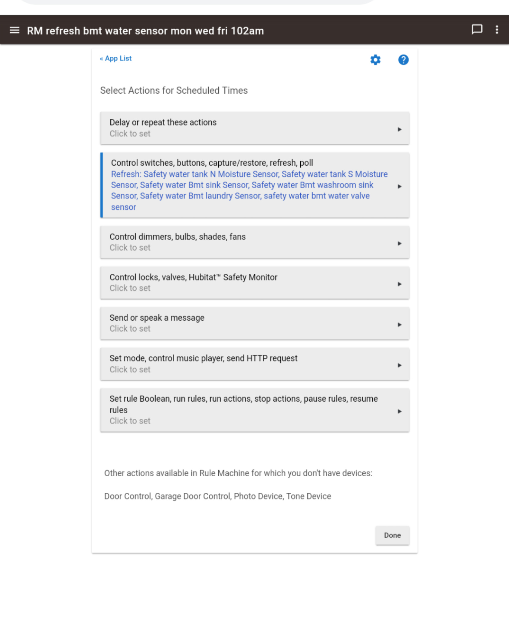

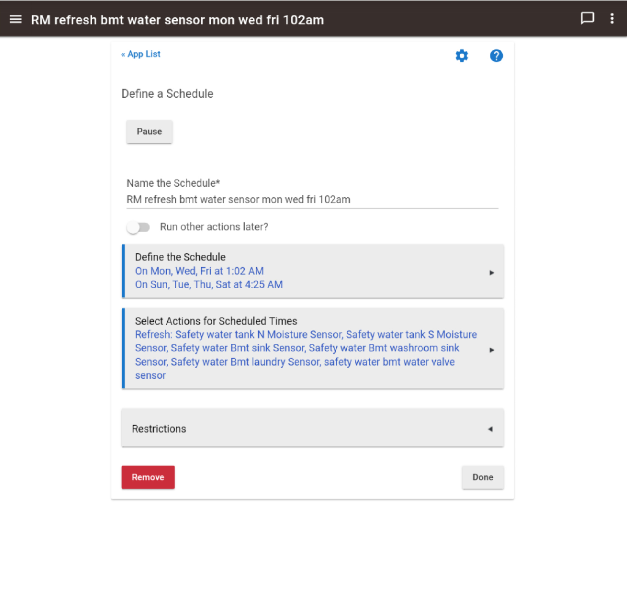

@Navat604 could I ask you how you refresh your sensor from RM? I don't see a Refresh option in RM... I am new though so this might be a dumb question. Thanks for your patience! :slight_smile:
My bad... I must have missed this. Sorry. I am going to do this... I am also going to try to send CONFIGURE periodically b/c I 've noticed a couple ST motion sensors pooping out and getting woken up by a CONFIGURE.
Thanks again!
No worries, happy to help. If you have many sensors then I would divide them to smaller groups instead of refreshing them all at the same time. Probably it's ok to do all at once but I have 100+ zigbee devices and don't want to hammer the signal.
