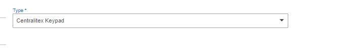

Are you using the Hubitat supplied driver or the Nyckelharpa Centralite driver from my app?

If you have keypad tones you likely are using my app's driver. Please confirm which driver is being used.

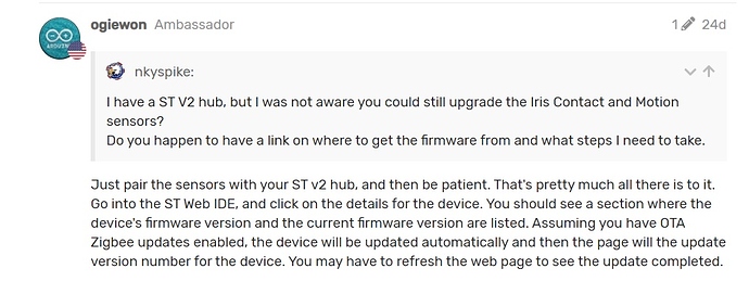

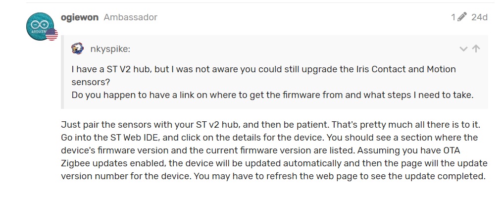

I'm not sure if it will work with the updating the last updated firmware for the Iris Keypad v3. But do you happen to own a SmartThings hub?
I was informed when I bought some Iris Motion Sensor and Contact Sensors (a month ago) that if you add them to the ST hub that it will update to the last released firmware. I was able to update all of the with no problem.
I was told best to add the devices to ST using the ST Classic app.
Here's a screenshot talking about it, hope this helps.
I do not have one.
What will the firmware give me? A different beep?
Smartthings can update the firmware on a few iris devices, but I don’t think the V3 keypad is one of them.
ST does not natively support keypad devices, nor does it update these devices.
