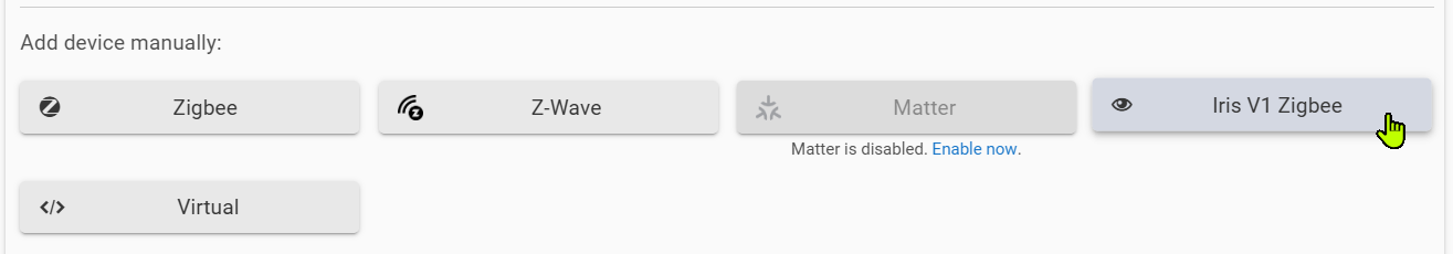

I left all my Iris v1 devices on my C7, which still supports pairing them, C8/C8-Pro do not support pairing Iris v1 devices. If you have them on a C8 or C8-Pro it would be via migration from a C7 or ealier hub to the C8/C8-Pro.
C7 (& earlier) Zigbee pairing options - includes Iris v1:
C8/C8-Pro Pairing options - no Iris v1 option:
If you have your previous hub(s) (C7 or earlier) I'd recommend using that to host your Iris v1 devices, and share them to the C8 via Hub Mesh.
