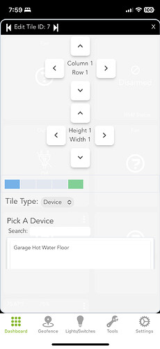

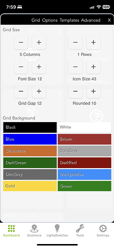

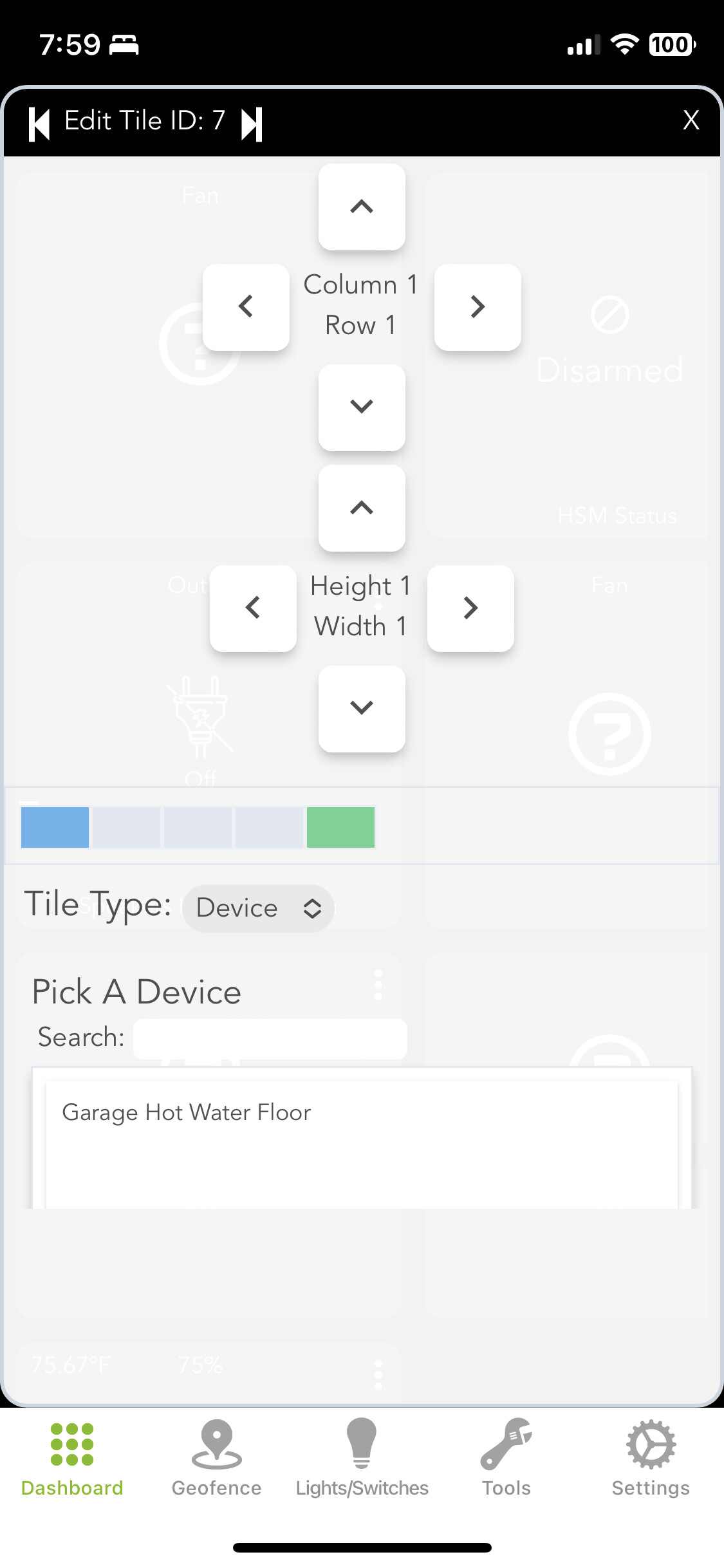

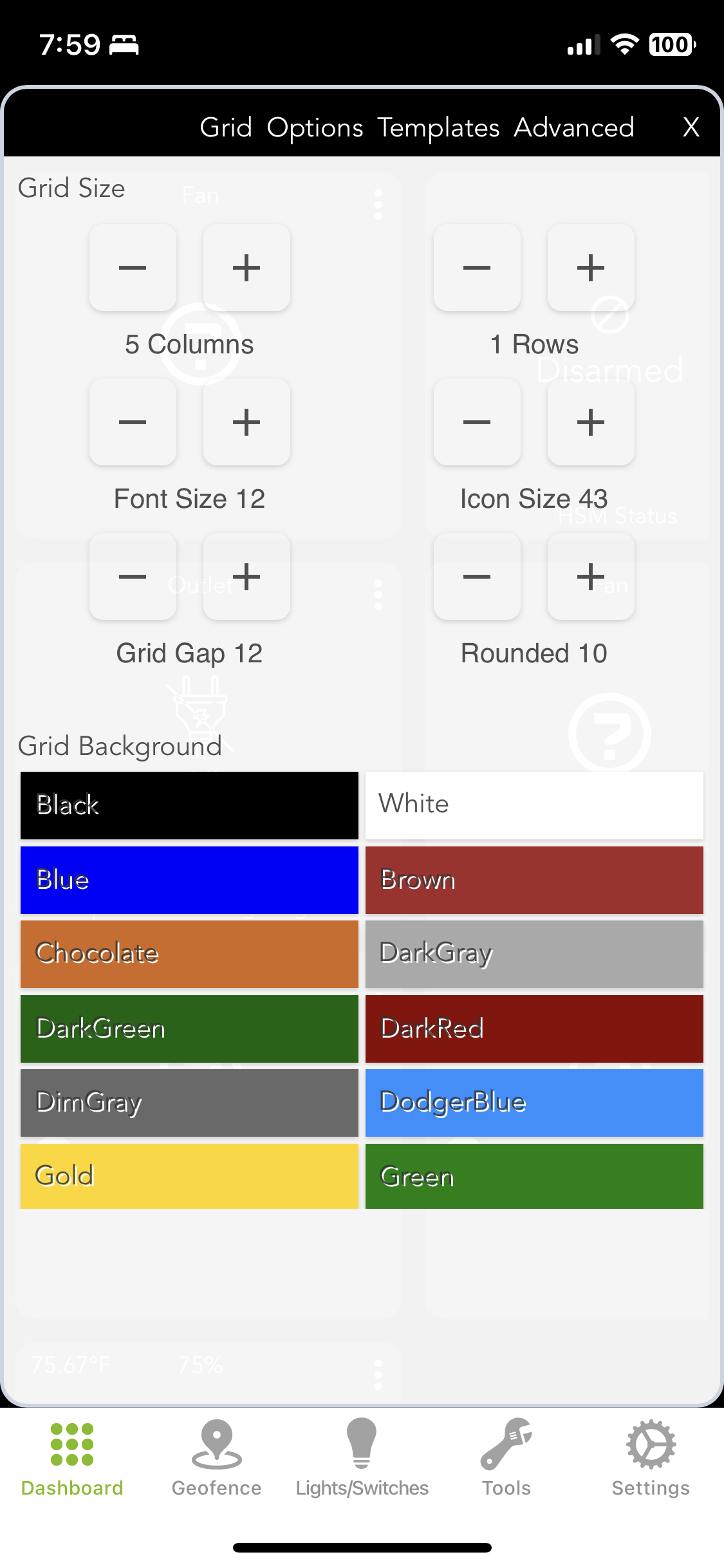

I'm guessing you know you can adjust an individual tile size by clicking the three dots on the tile and adjusting the height an width in the dialog that pops up. I expect the settings you are after are the one is the dashboard configuration (click the cog icon typically positioned in the top right of the dashboard. In there you can adjust the width and height for one increment of a tile size.

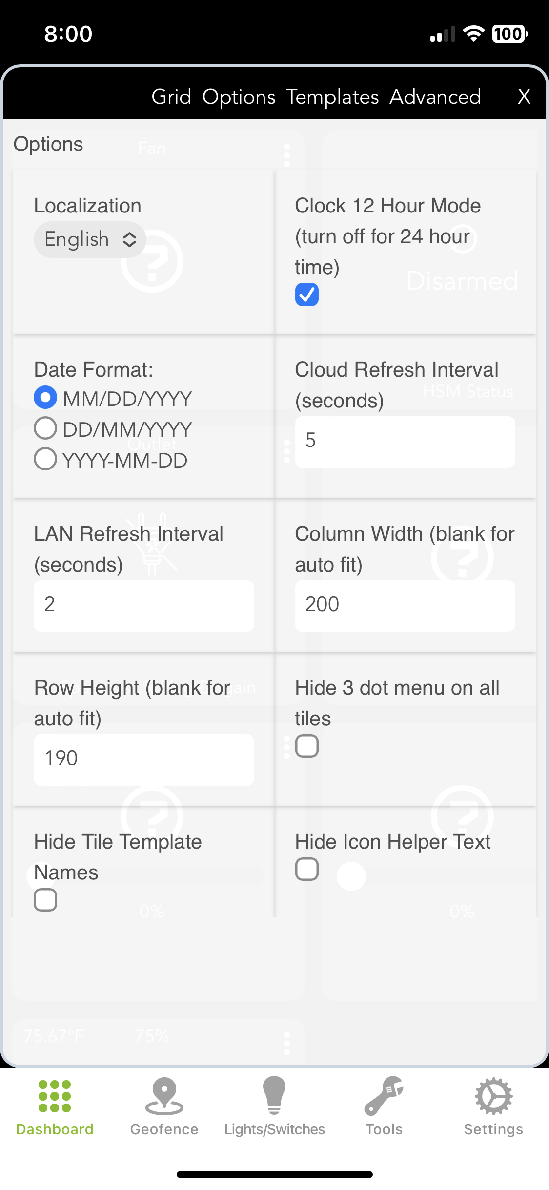

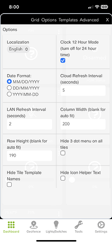

Hi both. Thanks for the reply. Here is what I have on the iPhone and iPad screens. The attached are from the iPhone, where it is most impactful on a small screen. I could not find out how to change the size of individual tiles to make the smaller. I can only make them larger.
From your your screenshots.... The first one includes the tile Column Width and Row Height, 3rd and fourth rows in the screenshot. Tweak these settings from 200 and 190 to see smaller tiles. Note that as you reduce these values the tiles become smaller, so you will want to make them smaller. So you may want to make tiles smaller in smaller increments, adjusting tiles as you adjust the bigger settings.
